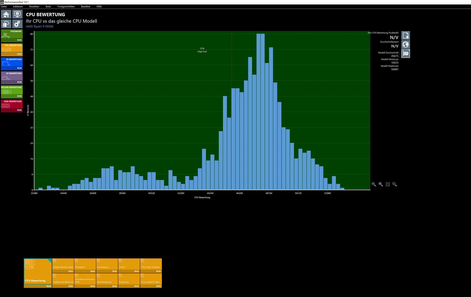

    When hover above the graph the App will instantly freeze and close after some seconds. As long i keep my mouse outside the graph window everything is fine.

      Hi Richard,
      as soon i hover above the green area it crahes.

        We managed to reproduce the error - seems like the German translation of strings that are part of that particular graph when you hover over the blue columns were too long and the program crashed as it did not expect such a long string. Will be fixed in the next release.
          It should be fixed in this build if you'd like to try it out.

            Hey Tim,
            works for me!
