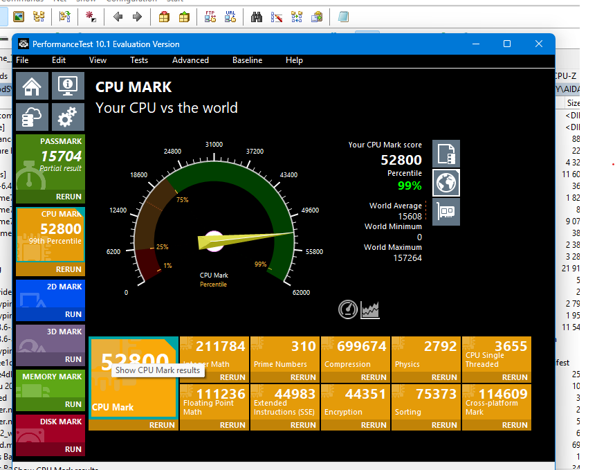

      Something's broken in the new PassMark 11.1. I've run hundreds of tests in version 10.1, and the results were always better. The 11.1 results are underestimated and shouldn't be combined with the 10.x results database because they're misleading and lower the processor rankings.
      Below is a comparison. Clearly, something has changed in Integer Math (always below 200,000 in 11.1 and always above 211,000 in 10.1), Prome Numbers, and Sorting. Either the algorithms have changed, or something in the new version is choking these calculations (it interferes with these tests).
      In the RAM test, something has also changed in Database Operations, as the results have now increased by several percent.​

        There were big algorithm changes between V9 and V10.
        The changes between V10 and V11 in the CPU test suite were smaller and the numbers are largely comparable. Your overall difference was 1.8%. And I suspect if you ran both versions 10 times and took an average the difference might even be smaller.
        But none the less, best practice would be to compare benchmarks from exactly the same version.

              The overall result doesn't change much because individual subtests have different weights and impacts. But I actually reran the tests in version 10.2 when I had some free time, and that's where the real problem occurred, which has been carried over to version 11.x.
              In 10.2, it's probably not the newer compiler version that's to blame, and it's not the same problem as in 11.x.
              I did a comparison; look at the huge difference in Prime Numbers! That's a 35% difference So even if it were a newer compiler, it would be a bit underdeveloped, calculating prime numbers much slower Similarly, Integer Math is always smaller in 10.2 and 11.x. I've run hundreds of tests on 10.1 (optimizing CPUs) and several dozen on 10.2 and 11.x, and it's repetitive. Sorting - something happened in 10.2, and the results were over 80,000 (even the scale ended, where are the results from the 9950X, etc., on the graph and scale? This is My CPU vs. the World, and they should be there. And from Threadrippers). In 11.x, they're back to normal and practically identical to 10.1, so it's probably not the compiler's fault, but a different algorithm was probably used in 10.2 for these calculations.

                I did some testing here. I found
                1) The string sorting test to be faster in V10.2.1017 compared to prior V10.x releases and V11.x. In my testing the difference was around 8%
                2) The prime number test to be faster in both V10.2.1017 and V11.x, as compared to V10.1.x. Difference was around 13%.
                In V11 we switched to using Visual Studio 2022 as the compiler. While V10 was built using VS2019. There were also some bug fixes and a bunch of minor changes. So some minor performance differences is to be expected.
                However, and this is the interesting bit, it appears that V10.2.1017 (the final V10 release) was also built with VS2022. Whereas V10.2.1016 was built with VS2019. This looks to be a mistake on our side as we try and avoid any compiler changes when doing patch releases. V11 was built using VS2022, but a slightly newer patch release compared to V10.2.1017.
                There were no source code changes to these tests on x86. There were some changes for the ARM release, as that we still new at the time.
                If you bindump the PerformanceTest .exe file headers for each of the versions you get this.
                V11.1.1007
                time date stamp Wed Sep 24 08:05:45 2025
                14.36 linker version​
                V10.2.1017
                ​time date stamp Mon Feb 20 15:51:32 2023
                14.31 linker version​
                V10.2.1016
                time date stamp Tue Jan 31 22:06:48 2023
                14.24 linker version​
                The linker versions relate to the version of Visual Studio used. So 3 slightly different versions. Which I think explains what you have seen.
