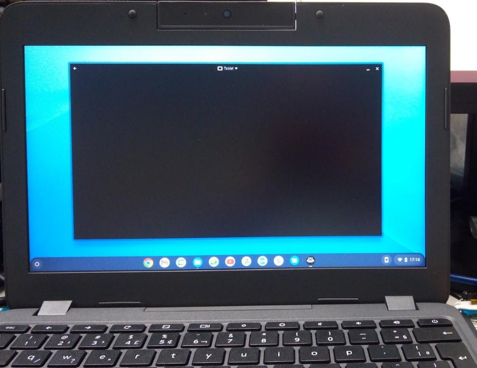

    Briefly describing the problem, it is possible to run PerformanceTest Mobile without any problems when Chromeboook is using ChromeOS version 96, but when ChromeOS is updated to version 103, the application crashes and there is a black screen without any information, as shown in the figure attached. I have noted this occurs after Memory Tests.
    I have tested both configuration Mobile, Tablet
    Please let me know if is possible to enable some debug information and where I can get the logs.
    I have tested 3 samples with the same issue.
    The hardware configuration is a Chromebook with Celeron N4020, 4GB LPDDR4, 32GB eMMC, LCD Size 11,6".

    The problem seems to be reproducible. We'll take a look at it.
      We'll take another look next week; it may be something specific with the setup. Can you pinpoint which test PerformanceTest for Mobile is crashing on? Try running each test individually by clicking on the test itself in the list. Some things to try...
      • Try restarting Chromebook before testing.
      • Make sure testing on AC plugged in.
      • Clear data cache for the app.

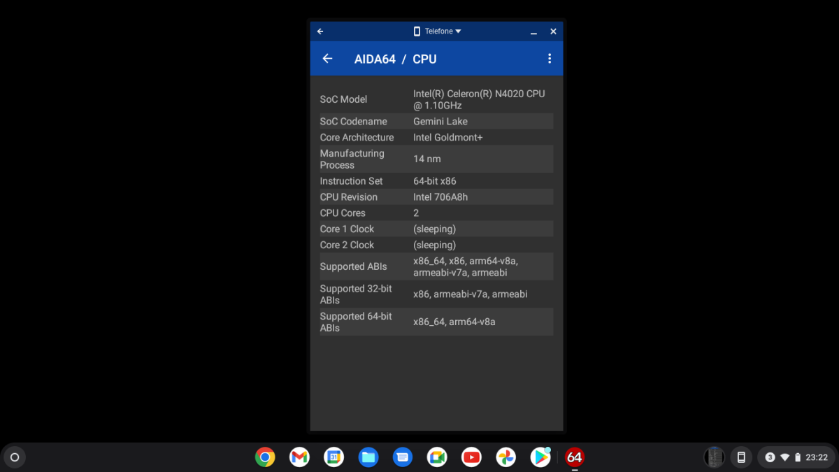

          Dear Passmark Support Team
          Follow the Chromebook configuration. It's Celeron N4020.
          Also another Chromebook with Celeron N4500 has the same problem.
          ChromeOS 103. Android 11
          I can run rach test clicking one by one.
          It seams the problem are in 3D Complex Test

            Thanks Aldiney for helping testing.
            We have found the issue and an update to fix the 3D Complex Test for Celeron N40XX should be rolling out shortly to all users.
