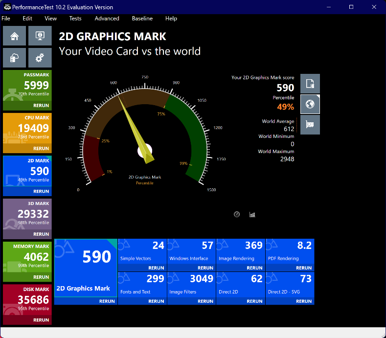

      Im a newbie, but Ive got to say something here. I have a above avg system with a Msi 3070ti GamingX. My 2D has been at a embarrasing 560-609 except for a few times installed new hardware or maybe when windows had a major update. At that time the score was an incredible 1400. There was no way to isolate the reason. Ive diagnosed, tweaked, updated, changed drivers, you name it. 99% of your inquiry on that will be answered "Ive tried that 4 times". But Im not quitting. Ive even tried tweaks from other posts, down to disabling prefetch. How could there be another cause of this with good eqt besides the testing. AND i havent looked but It seems many people have this. Are you suspecting anything?
      • Robert Childers
        • Jan 2023
        Regarding the previous post 12;44am, the harware utilized include: 10700kf @5.09gz, Msi 3070ti GamingX, Oloy 32gbddr4@3333mz, Evo970Plus 2tb, Corsair RM850, Lg 4k 32UK-T50.

          RE: Previous Post "IM a newbie"
          There was a time when 2d skyrockets. I have an LG driver which is avalaable on-site. It includes the icc. I tried with a different icc, no help. BUT when the generic driver is used on my 4k monitor 2d goes up. It would be convenient to say "well then thats LG's fault", but how do I know the driver is wrong, it comes off the LG site. When I use the generic my color management will NOT connect to the monitor, so now I have to use it!!
          Is 2d supposed to rise when color management is not connected anyway?
