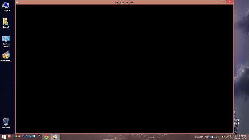

    Hi, as the title says, I'm having a problem with the DirectX 10 test which is "unable to run at the desired resolution" - that's what the software says - and penalizes the outcome of 3% when I'm able to make it run at a different resolution (1680 x 990). Basically. when the test screen comes up it's all black and frozen, along with everything else (meaning I cannot use my pc) until I call up the task manager via hot keys (ctrl+alt+del), then drag the test window, even very slightly, and only then does the actual test begin. That's when I can read the different resolution warning; this happens both when I run the test singularly and when I run all tests. I've tried running my GPU at both stock and OC clocks but I get the same outcome; same goes for my CPU: I've run it @ 4.2, 4.4, 4.5, 4.6, 4.7 and 4.8 Ghz and I still get the same error. Any help would be appreciated.

    What resolution are you running your monitor at (while on the Windows desktop)?

      Resolution is the recommended at 1920 x 1080.

        One other thing: my monitor is actually a tv and it's connected via hdmi cable....

          I've tried switching monitors but it doesn't make any difference.

            If you go into the Windows control panel and change the monitor's resolution, does the video card / monitor combination that you have support 1680 x 1050?

              Yes, it does.

                Ok, I can confirm that Windows 10 has solved the Directx 10 problem; however, the Direct 2d one still persists. To be honest, there is a slight improvement but the result is still nowhere near where it's supposed to be.
                  We don't really know the cause of the issue. But thanks for the follow up.
