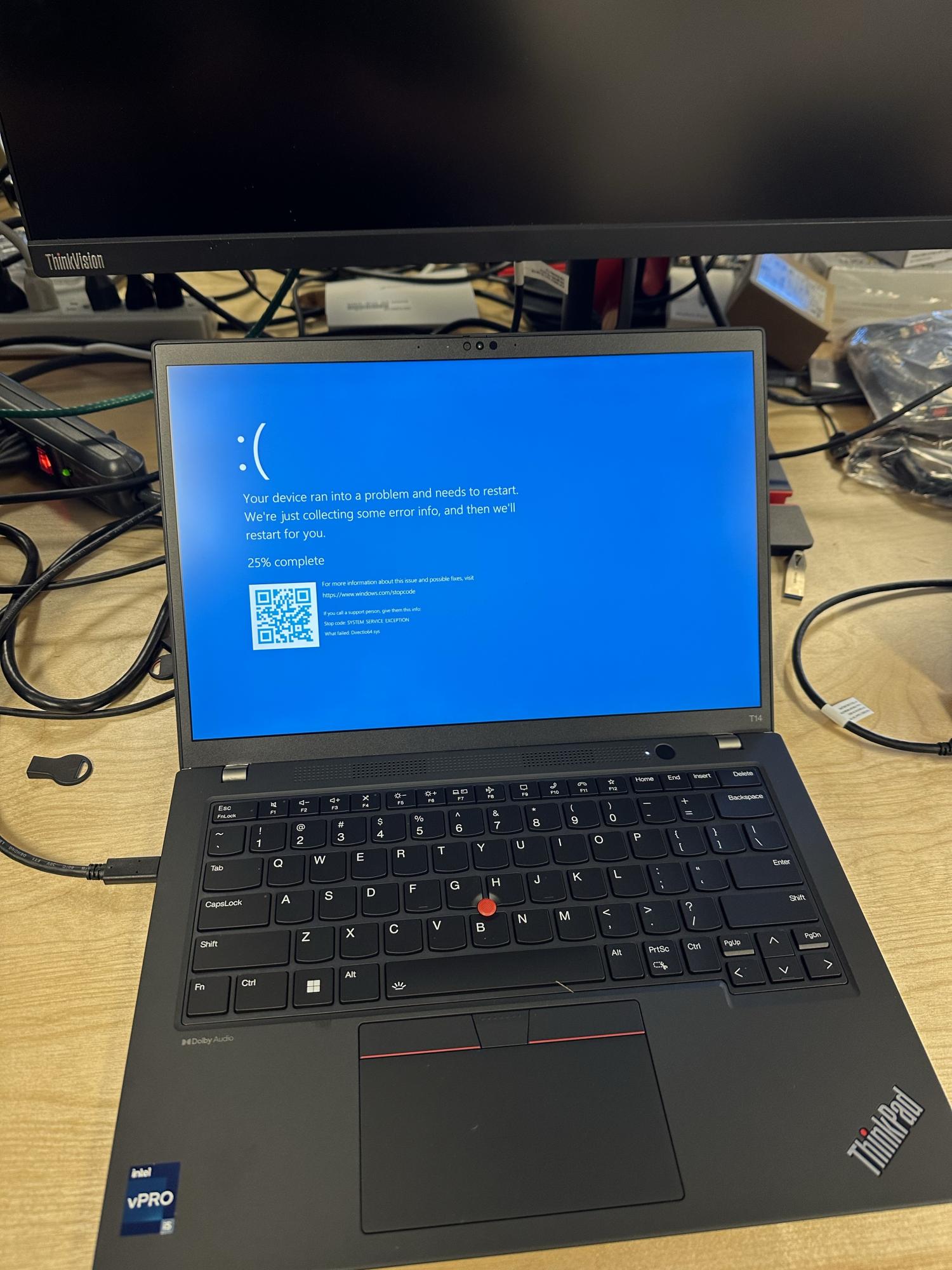

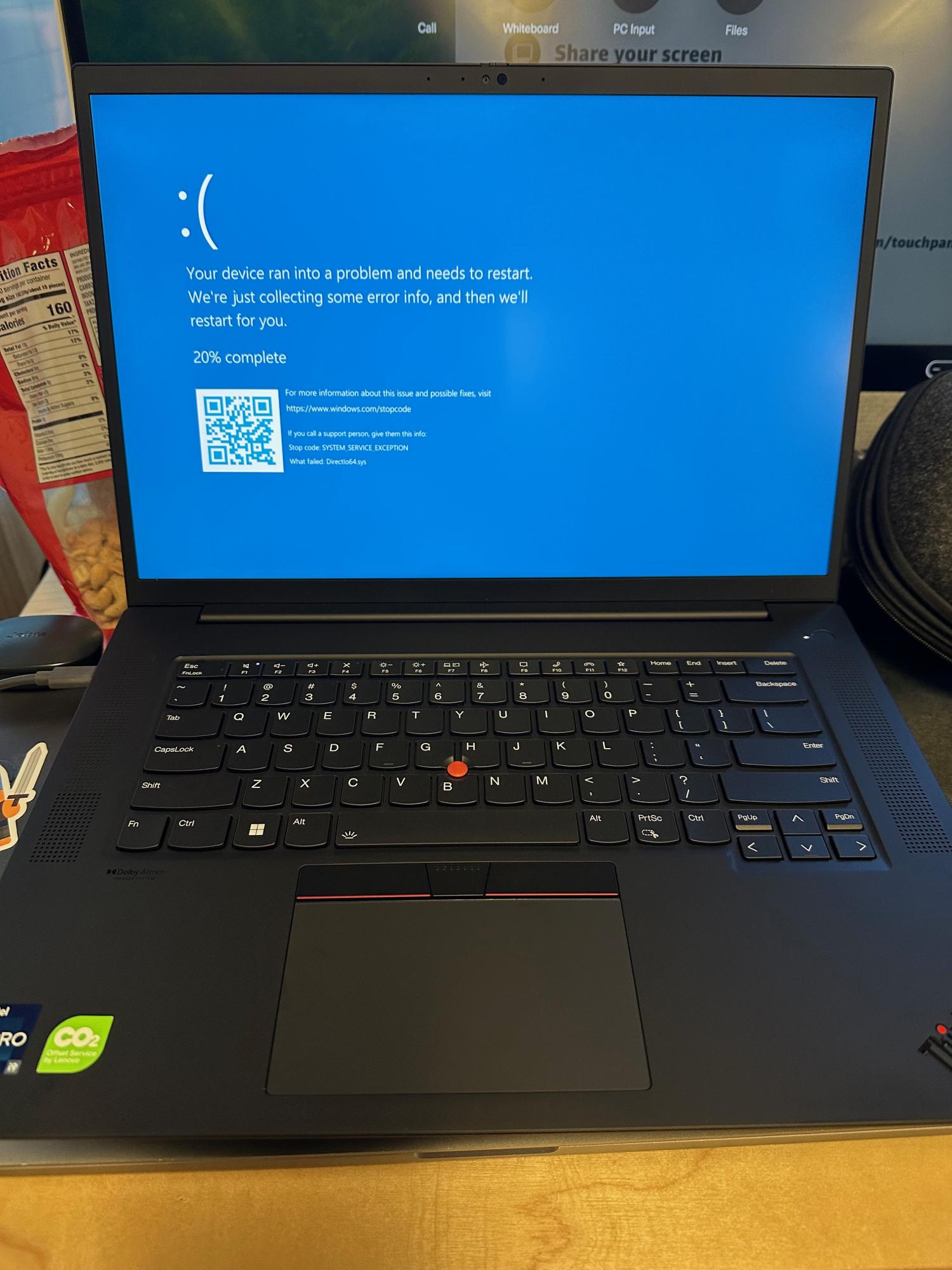

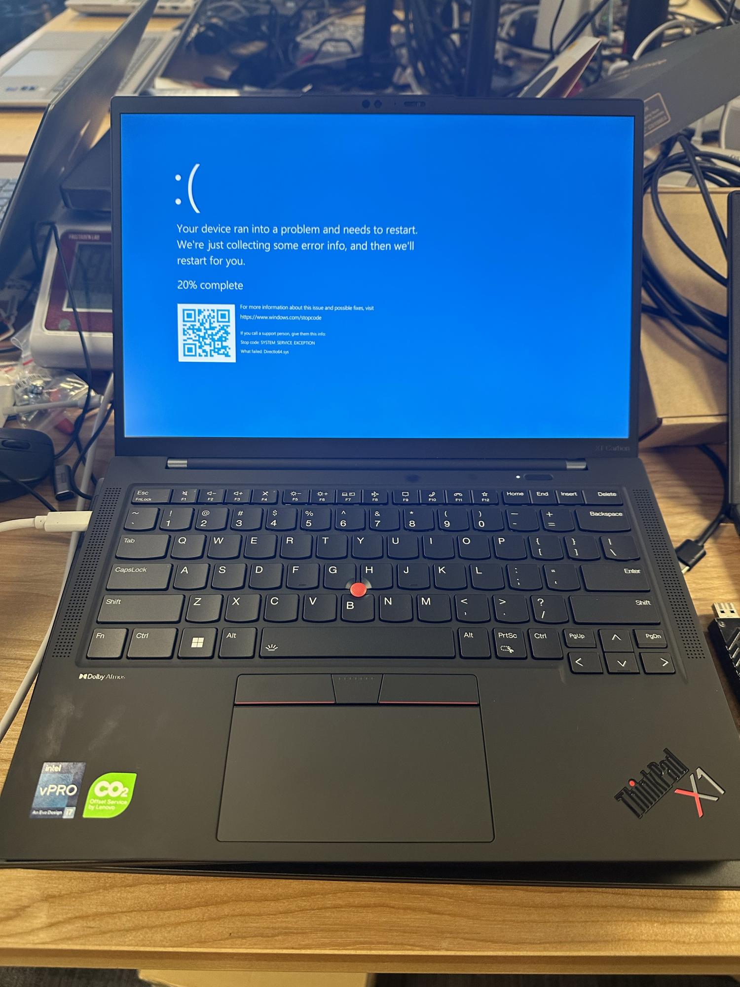

    So my company is going through an RFP and one of the tests we run is passmark (along with PCMark10 and a few others)
    We got the latest wave of laptops from Dell/Lenovo/HP and when I installed and launched passmark it would bluescreen every time when it was running the Memory SPD info scan.
    I engaged the tech people from each company and they narrowed it down (after sending endless logs and system captures) to... a BIOS setting.
    "Enhanced Windows biometric security" (goes by slightly different names from each manufacturer)
    Turned that off and no more bluescreen. Weird!
    Any idea why this would cause passmark to freak out?

      I have a memory dump from each model it happened with... although they are ~1.6gb ea, if yall have a FTP server or something I could dump them to I could send them. Also have pictures of the blue screens. I thought i had the stop code from the bugchecks in event viewer but they were pretty non-descript. 0x0000003b System Service exception
      Lenovo models I saw the issue on:
      X1 Carbon Gen 11
      L14 Gen 4 (Intel CPU, not AMD)
      L16 Gen 4 (Intel CPU, not AMD)
      P1 Gen 6
      Also saw it with the HP Elitebook 8x0 G10 line but only my retail samples. The ones that were already pre-configured for us (using our customized BIOS load) did not show the issue... .but thats because that BIOS setting is off on our corp BIOS load.
