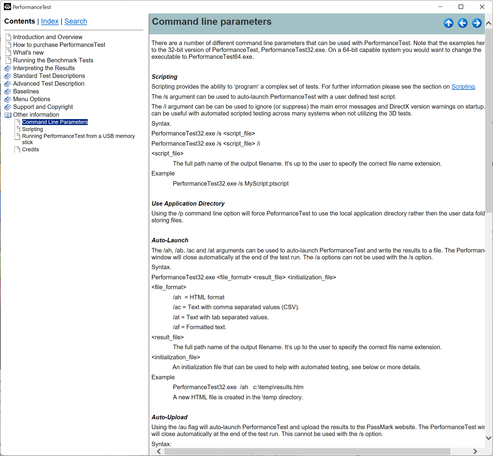

    Hi, I was looking into the forum to see if i can get information to the explanation of the command line parameters explanation for performance test but to no avail (maybe not looking/searching hard enough).
    Eg, processes - does it equate to hyper-threaded core or something else. Why processes parameter (or argument) value at 1024, what is the meaning of duration for short, medium and long etc.
    I want to look for some guide explanation these. I sure need some help to direct me to the source which allow me to understand what each of the parameter means (in layman explanation).
    I want to do performance test on a server and its better to understand each parameters mean, so that when I do the test, I can adjust accordingly to observe and better understand/appreciate the output.
    Thanks for any help. Cheers.
    The Help file (under the Help menu) in the software is the best place to start.
    Extract is below.
