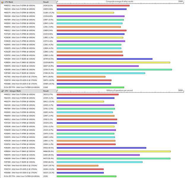

                      Thanks for the update David. May I attach the single thread results of my 4790K @ 4.8Ghz (HT On). The results also show baselines of the top of the list of highest overclocked 6700k's, as well as a few other different CPU's.
                      I clearly see the 4790K beating the 6700K's. There is a 5ghz 6700k which mine ranks higher than.

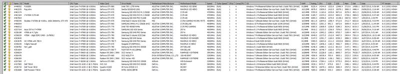

                      It's a shame the baseline listing of details for each machine is NOT showing the actual overclocked rate, because unfortunately, I'm forced to refer to the managed baseline summary window to see this information and the other unfortunate thing is that this window hijacks the entire program and we can't click back to the main results window to reference the machine # to the same one in the baseline window tocorrelate which machine is which, in this case trying to ID which machine is the 6700K clocked at 5ghz.

                        In the baseline search window you can look at the 'Speed' and 'Turbo speed' columns to work out which machines are overclocked.
                        In the advanced search tab you can also sort by 'Turbo speed', then 'Speed'. Doing this shows there are five 6700K baselines with overclocks above 5Ghz. Baselines 538341, 571826 & 553943 have a turbo speed over 5Ghz and baselines 547593 & 448552 have a base speed over 5Ghz.
