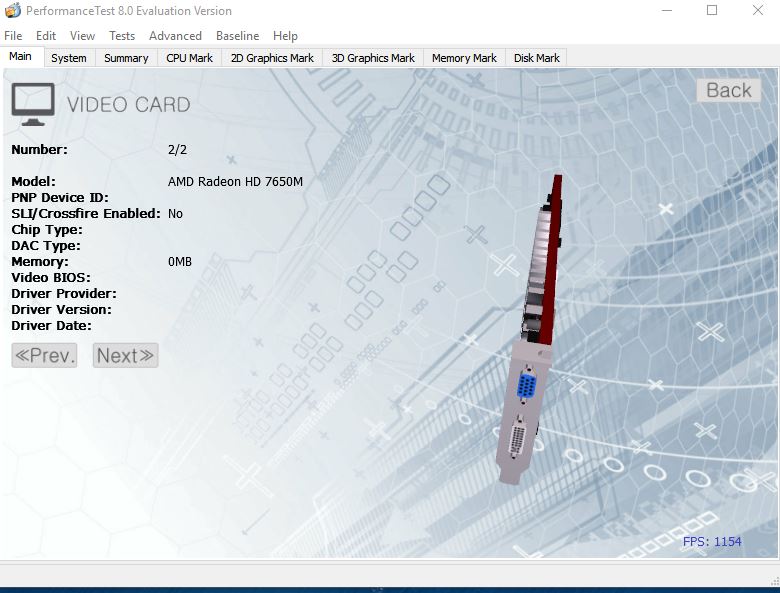

    I have HP 4740s laptop with Intel HD 4000 and AMD Radeon HD 7650M graphic cards. I have Windows 10. I have also installed latest drivers for both cards.
    When I run Performancetest it always run on Intel never on AMD (ATI). I checked that both cards are working in other apps. I also found that in AMD properties it looks like on the picture below.
    Is anybody knows how to resolve this issue?

        Meantime I found that there is update to build 1053 which still doesn't recognize my card but it is able run it and test it. So it is enough for me
          Could you please launch PerformanceTest in debug mode (explained here) and send us a copy of the debug logs that are created so we can check out why there isn't more information for the AMD card.

            I am sorry for delay but I was busy last days. I already send log files as you asked.
            best regards,
            da1k
