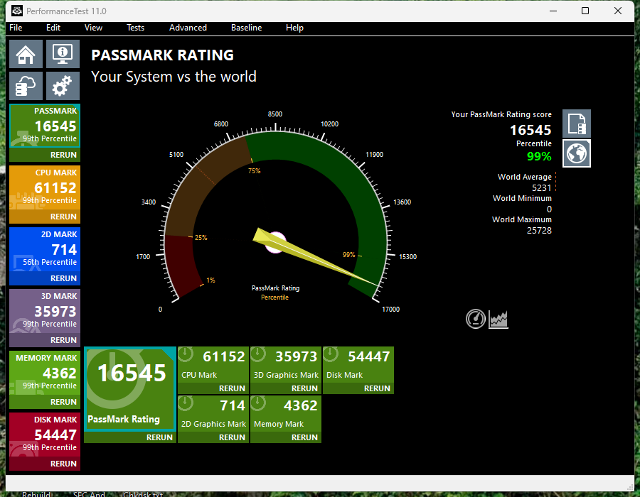

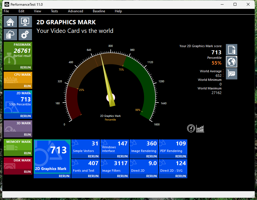

    After Updating to Version 11 Build 1017 of Performance Test, my 2D Graphics Mark seems to be cut in half. It was around 1600 with V11 Build 1016, with V11 Build 1017 it is around 700. No changes were made to system hardware, driver updates or Windows Updates. Have attached 2 screenshots (one with build 1016 and one with build 1017). Also, system info.
    There was no changes made to the 2D benchmark test between these releases.
    Is this reproduceable with build 1017 or was it a one off bad result?
    What are the individual results for the suite of 2D tests?

      I get about the same results for the 2D Graphics Mark every time I run Build 1017 (about half what it was in Build 1016). I even uninstalled Build 1017 and installed Build 1016. When I run Build 1016 the 2D Mark is about double that of Build 1017. Uninstall Build 1016 and install Build 1017 and 2D Mark is about half that of Build 1016. Like I said, no changes in Hardware, Drivers, Windows Updates or Windows settings. Settings in Performance Test are default. Have attached screenshot of just 2D Mark in Build 1017.

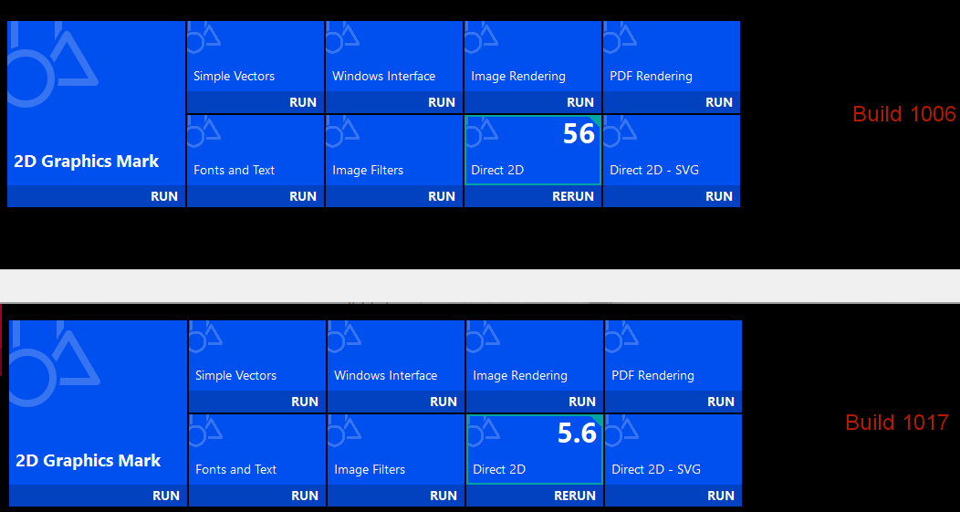

          OK, you are right. Something got busted.
          Your Direct2D result is very low compared to what it should be for your hardware. All your other tests appear fine, above average in fact.
          I also replicated a before / after bug on my machine with the latest patch release.
          The benchmark test itself is fine (and the correct FPS data is displayed while ​the test is running) but when displaying the result, somehow we now have the decimal point in the wrong place!
          Pretty strange and not deliberate.
          We'll investigate and get it fixed tomorrow.

                  Should be fixed in release V11 Build 1018
                  https://www.passmark.com/products/pe...st/history.php
                  The problem was that the system information was not being collected correctly for the display. So it looked like the primary display had a resolution of 0 x 0 pixels. This then messed up the scaling of this 2D test.
                  We are going to flag all submitted results from build 1017 as invalid, given the test results are wrong.
