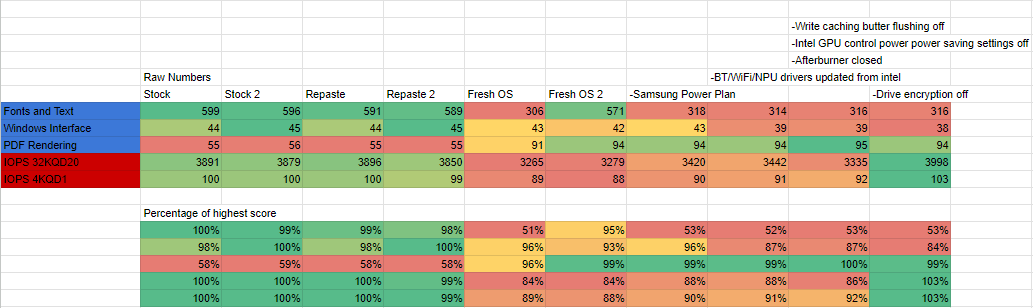

    I recently purchased a Galaxy Book4 Pro 360 (155H CPU w/ NPU and Arc graphics) and did a fresh install of Windows 11 on it. Before the reinstall, and during various changes after, I ran some PerformanceTest benchmarks. A few strange things:
    • After the OS reinstall, my Fonts & Text score was half of what it was prior (there was one score after that was close to the original, but the other 5 runs were around 50%).
    • After the OS reinstall, my PDF Rendering score increased by about 65%.
    • When updating the NPU driver from the newest Samsung one to the more recent Intel one, Windows Interface scores dropped to about 85% of what they were originally.
    • Disk random read/write scores dropped by about 10% after OS reinstall, but this turned out to be due to device encryption being enabled by default.
    I have done my best to make all test conditions controlled, including watching temperatures, background processes, matching settings, disconnecting all external devices, etc. I restart between runs and let the computer return to idle temperatures between individual tests (on that note, some setting to go through the entire battery of tests with a configurable delay between the individual tests would be awesome).

      Interesting about the NPU... So very application specific, and only in use when very specifically called for it seems? No chance Windows choosing to use it for a certain task?
      Most of the test results do have the expected random variability, but the ones I mentioned were switching between two fairly consistent scores:
      PDF rendering and IOPS are pretty clear in when the change happened. Fonts and Text is odd because of that one higher score after reinstalling Windows. Windows interface is a bit strange too. It has a smaller decrease (but still consistent), and it happened after I replaced the latest Bluetooth/WiFi/NPU drivers from Samsung with those from Intel.

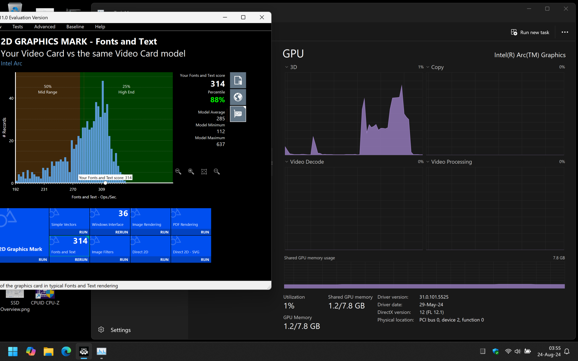

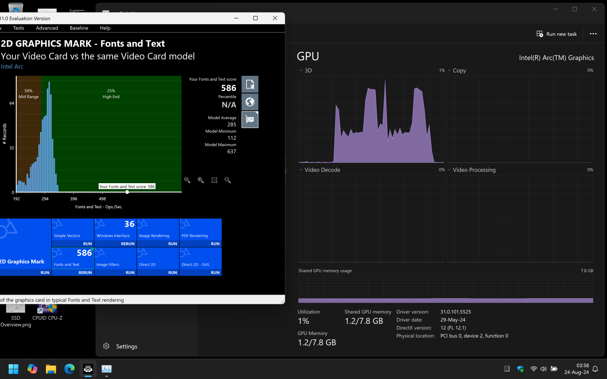

              Alright, after much more testing, I have been unable to isolate any variable that determines which of the two results I get for the Fonts and Text test.
              I did notice something though that makes me thing the issue might be with the test itself. On test runs where I get the higher score (585 or so), the test lasts for about 39 seconds. On runs where I get the lower score (315 or so), the test lasts for about 21 seconds. Assuming the test score is proportional to some number of operations or tasks completed during the test, then this seems to be an issue with the test not terminating properly. The score/time ratio is exactly the same, at least within my accuracy with a stopwatch.
              Here is a screenshot of an example of each test result, with task manager showing the GPU utilization during the tests.
Name:	graphics usage 300 normal.png
Name:	graphics usage 500 normal.png
