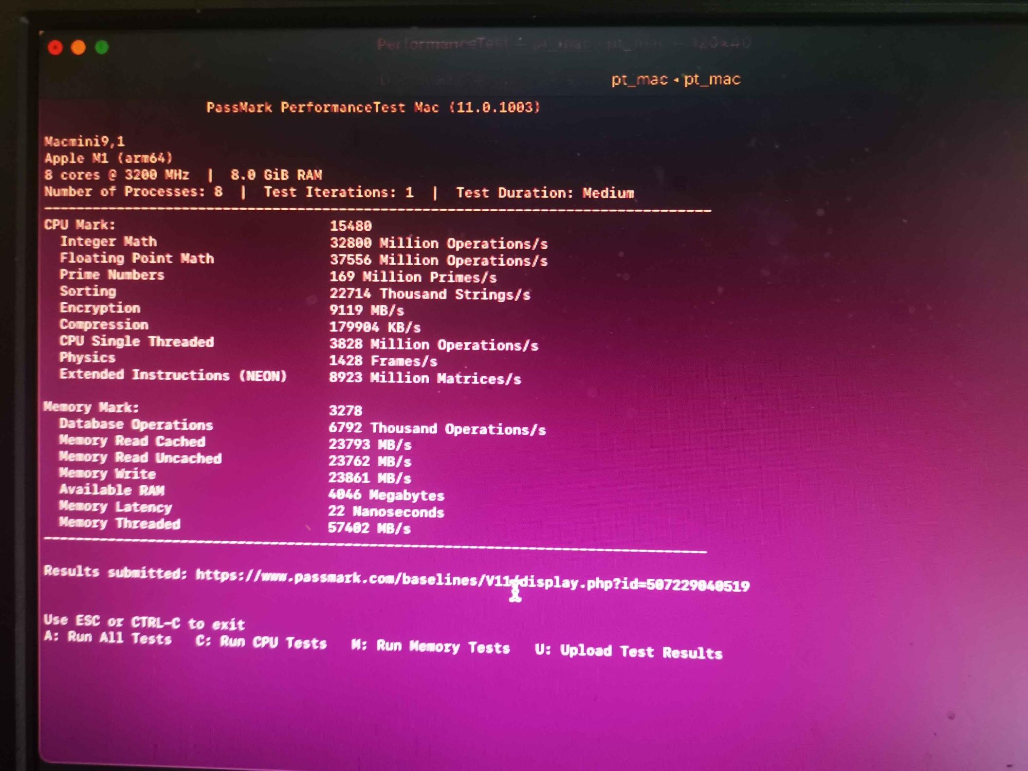

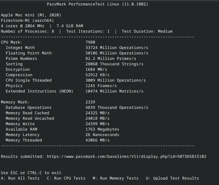

    As stated in the title. When running Performance Test in Asahi Linux it recognizes the CPU as an 4 cores, 8 threads CPU @2064 Mhz (which is the E-core clock frequency if i am not mistaken)
    and i get about half the CPU mark that i would get running the same test under mac OS
    Is this expected behavior? i provided screens from both results on both OS
    Both screen shots show 8 threads. So the benchmark results should be valid in both cases.

      Thanks for your quick answer.
      I should have explained myself better
      Both test run on the same dual boot machine so hardware is the same
      if checking clock speed with htop on linux i can confirm that all cores at being used at full speed during benchmark
      Only hardware i assume is not being used in asahi linux is the NPU
