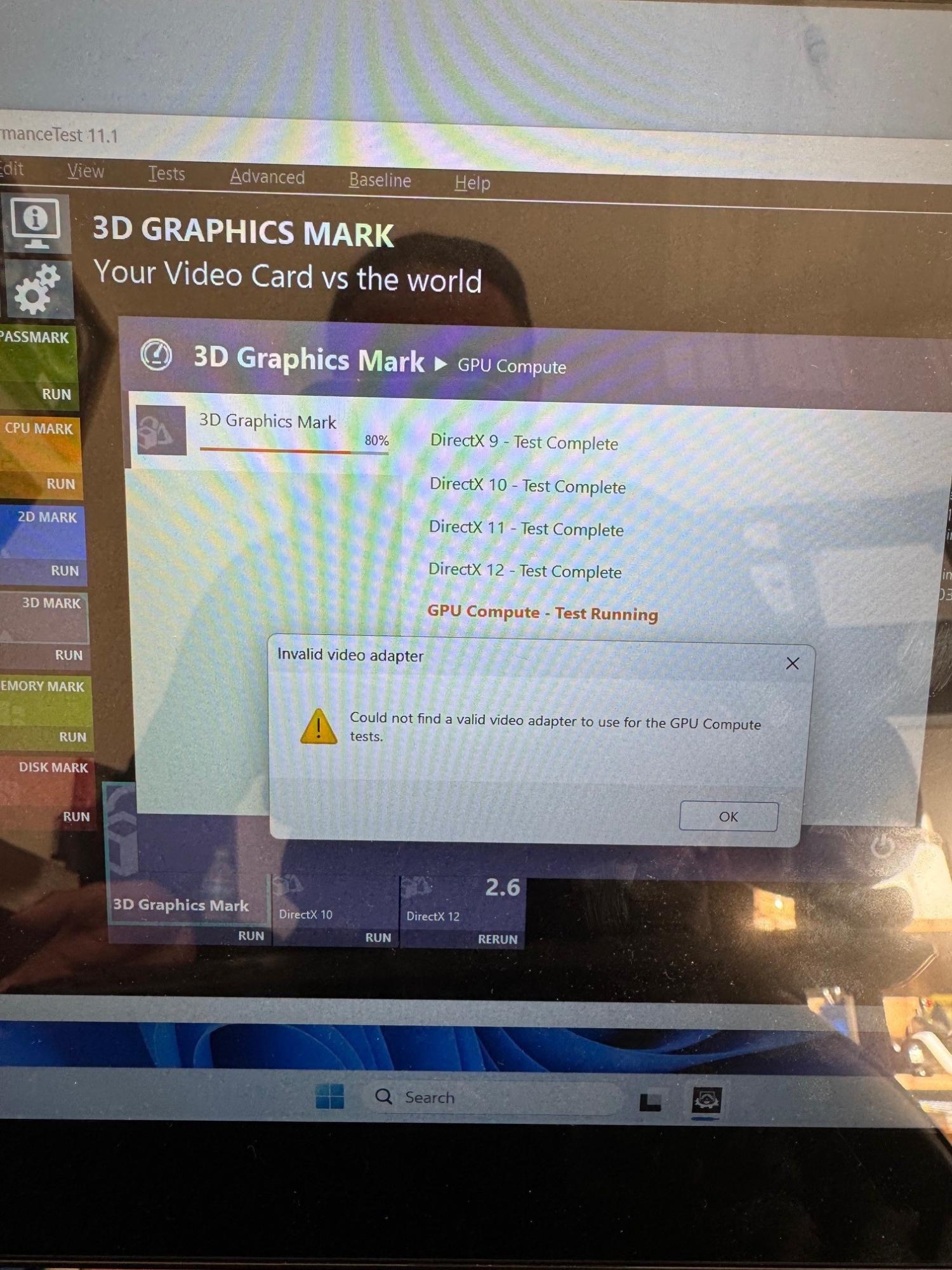

    Dear PassMark Support Team,
    Our internal engineering team has been conducting tests using the PassMark Performance Test software and has encountered a potential issue related to the GPU testing module in the latest version. Below is a summary of our observations:
    1. Testing on v10.2:
      • We performed multiple tests on the same machine using Performance Test v10.2.
      • No errors or abnormalities were observed during these tests.
    2. Testing on v11.1.1002.0:
      • After switching to Performance Test v11.1.1002.0, the first few test runs were successful without any errors.
      • However, after further repeated testing on the same machine, we experienced the issue once.
      • This behavior did not occur at any point during our tests with v10.2.
    Based on these findings, we suspect that the issue may be related to changes in the Performance Test software between versions 10.2 and 11, particularly in the GPU testing component. We would appreciate any guidance or further analysis on whether there have been known issues or changes that could explain the behavior.
    Please let us know if there are additional diagnostics or logs we should provide to help with the investigation.
    Thank you for your support.
    • 11112
    Error was: Could not find a valid video adapter to use for the GPU compute tests.
    CPU was: Celeron J6412
    GPU was: Intel UHD Graphics
    From the log file we see this
    331.656s - GetCombinedAdapterList Getting OpenCL Adapters
    331.719s - ERROR: clGetPlatformIDs failed (1) [-1001].​
    The function clGetPlatformIDs failed. Documentation is here.
    https://registry.khronos.org/OpenCL/...atformIDs.html
    The return code is CL_PLATFORM_NOT_FOUND_KHR​ (numeric value -1001)
    This isn't a known issue.
    If it initially worked, our guess is that the video card device driver crashed at some point during the tests. So maybe a bug in the driver.
    There were many changes between V10 and V11. Full list is here.
    https://www.passmark.com/products/pe...st/history.php

      Dear David,
      Thank you for your response. I would like to confirm that during our repeated tests, the issue occurred intermittently—sometimes it happened, and sometimes it did not. However, this issue never occurred in version V10. Are there any changes in version V11 that could potentially cause this issue?
      The main concern is that all tests in version V10 ran without any problems, while in version V11, the issue occurs sporadically. I noticed in Build 1024 that there were related fixes and modifications to the 2D test. Could these changes possibly be the cause of the issue?
        • 11112
        https://www.passmark.com/products/pe...st/history.php​
        We don't know which specific change provoked your driver crash (assuming that is what it is). Obviously the changes to the 2D, 3D & GPGPU tests would be the ones to look at.
        Sometimes driver crashes write a log record into the Windows event log when the fail. But not always. So you could have a look at the Windows event log.
