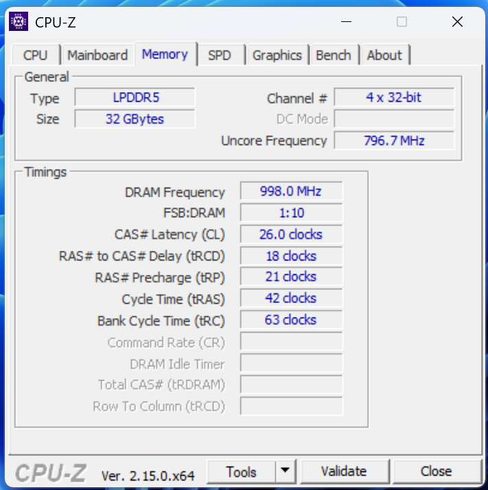

      Investigating my system itself as I think the benchmark is working as intended, I've looked at similar systems on here though and it seems they are getting roughly the same benchmarks. Specs on the memory are 32GB LPDDR5X 8000, CPUz however reports 4x32 @ 998 MHz, which I guess would be 4000 MHz, half of what the specs say. Maybe I am thinking wrong on something here..,? but that would also explain why I am thinking the memory benchmark is slow. Link to my Passmark run: (tested on main power)
        This doesn't make sense to me. 4 x 32 would normally means 4 slots with 32GB (so 128GB). Which isn't right.
        998 MHz is also way too slow for DDR5.
        But beware. Modern laptops ramp their RAM clock speeds up and down when under load. The clock speed is variable.

            4 x 32
            From the screen shot I can see what you are talking about now. DDR5 has two 32bit channels. Memory controller also has 2 channels. So 4 channels. This is not related to the clock speed or MT/s value however.

              I guess I was thinking for some reason the Channel # were representative of each stick of memory (4 sticks) and then that number was multiplied by the indicated DRAM frequency (998 in this case) to get the total frequency, which would be about 4000. I guess that's where I am getting confused as I would have thought the DRAM frequency should have been about 2000 * 4 channels = 8000 (rated frequency)

                I'm fairly sure the value in task manager is the maximum configured speed, not the current real-time speed.
                  I agree. Oh well, the tested speed is slower than I was hoping, but on a whole for the form factor of this laptop it runs very well. If I did not see the memory benchmark, I would never guess it was maybe a little on the slow side. Thanks for your input.
                    The 8000MT/s speed is actually very high (as at June 2025).
                    But by only looking at the clock speed, you are only getting half the story. The timings also play a big part. These are 4 numbers like, 38-50-50-128. They are known as the CAS latency (CL), tRCD, tRP, and tRA values. They are measured in clock cycles.
                    tRCD - Row Address to Column Address Delay
                    tRP - Row Precharge Time
                    tRAS - Row Active Time
                    So for example, 38 (CAS Latency, CL) means it will take 38 clock cycles for the RAM to respond to a read command after receiving it.
                    So high clock speed doesn't mean too much, unless the timing numbers are also reasonable.
