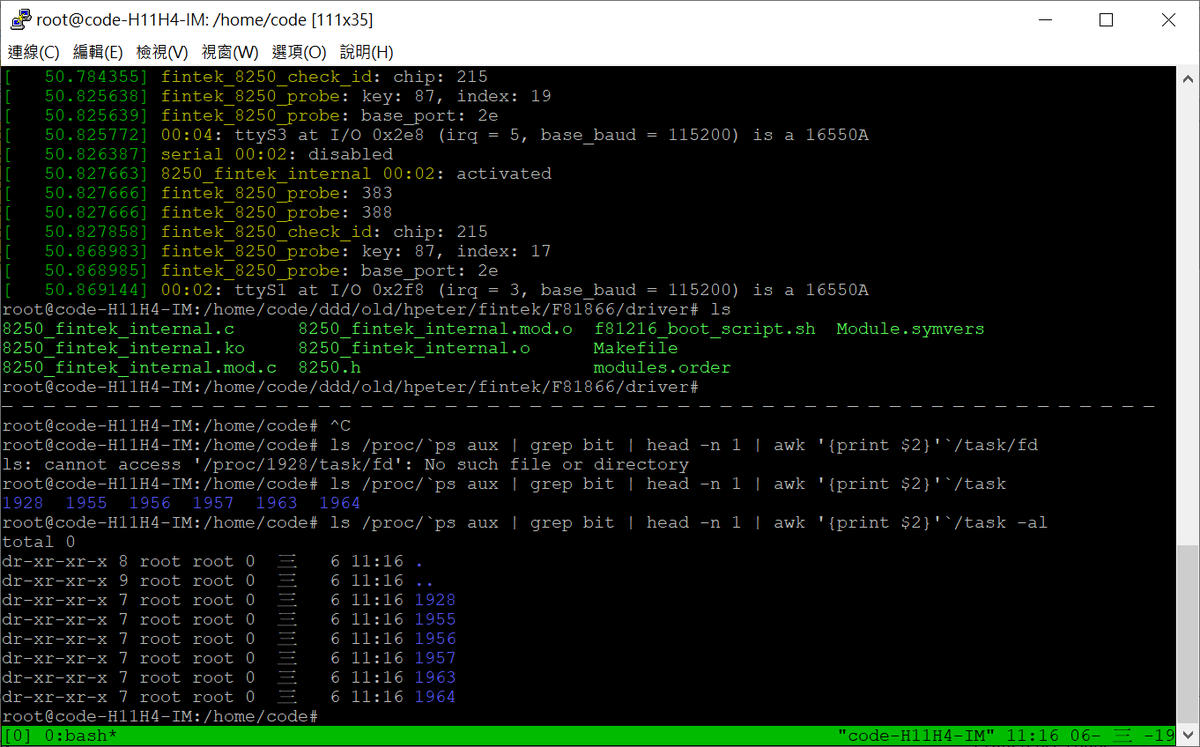

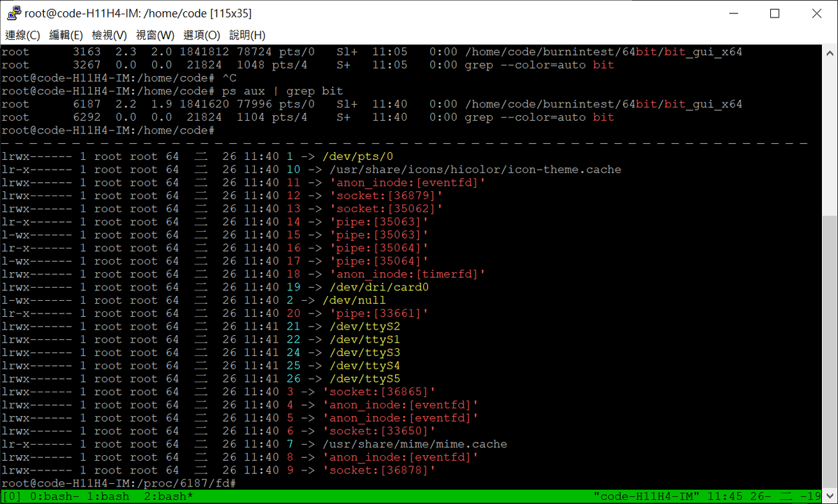

    Linux BurnInTest serial port test not close port on press stop button, ttySx will failed, but ttyUSBx is ok.
    If only open 1 ttySx, this bug will not appear, must open more then 1 ttySx to get the bug.

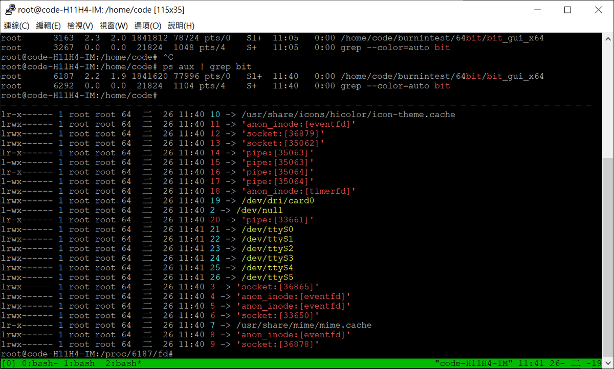

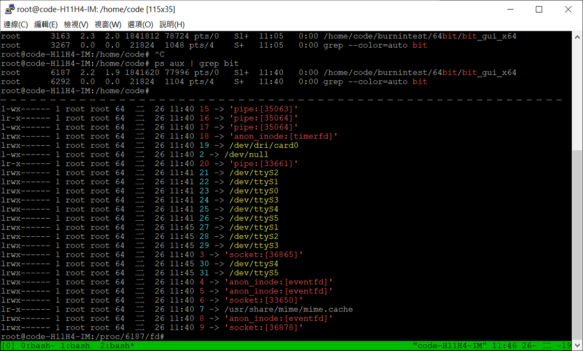

    The attachment of picture will use 6 serial port to to self test. We can see "3_stop.png", when stop the test,
    the file descriptor will remain and not closed. So when re-run test (4_re-run.png), some serial port will double open
    and make the test failed.
