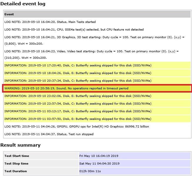

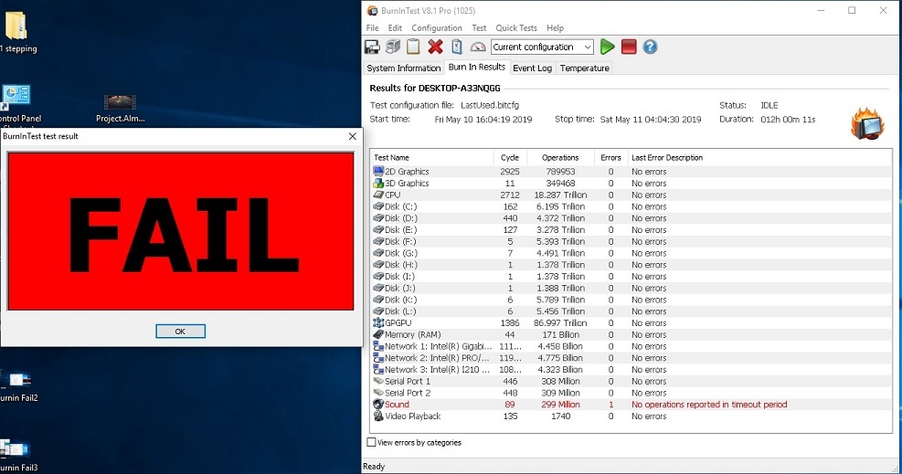

    Error as below:
    Sound, No operations reported in timeout period
    We test total four systems. All systems can copy the issue.
    And burn in test able to continue.
    Do you have any suggestion?
    The test result is following as:
    The warning message is following as:

    My guess would be that the sound card device driver crashed. There has been a long history of bugs and memory leaks in the common sound card device drivers.

              No I don't think the problem is related to the CPU.
              If the sound card test crashes, we think it is bugs and memory leaks in the sound card device driver.
              If you search the forums there are dozens of reports of similar issues going back over a decade. Unfortunately everyone sticks their heads in the sand. Rather than reporting the problem to the sound card vendor and getting it fixed, then either ignore it, blame something unrelated or change the test scenario to avoid triggering the driver bug.
              We also no longer support V8. Consider upgrading to V9,
