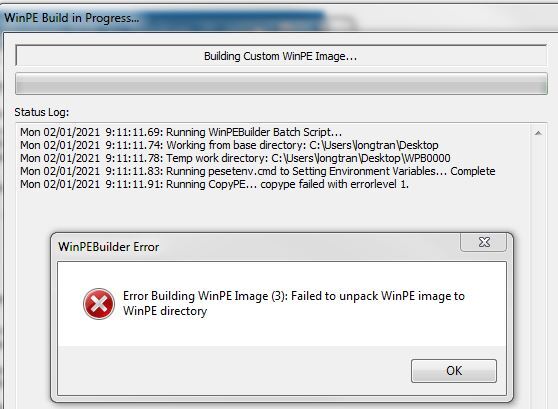

          Hi David,
          Below is what step I did:
          1. Download Windows ADK for windows 10 version 1809 and Windows PE add-on from Microsoft website.
          2. Install Window ADK with Deployment tools and Window PE add-on with Windows preinstallation environment. Both into the same directory
          3. Start "Deployment and Imaging Tools Environment" to run command "copype amd64 C:\WinPE_amd64" to create WinPE_amd64 folder.
          4. Download "winpebuilder" from passmark website and unzip.
          5. Run "Passmark WinPE builder for Passmark programs".
          6. Step 2: choose Target "64-bit". WinPe version: "WinPE 3.0" . Window AIK or ADK installed directory: direct to folder "Windows Kits\10" from C drive
          7. Step 3: Selected program exported file directory: direct to Pasmark 9.0 folder . Choose "1-Mounts all available storage deivecs"
          8. Step 4: Add driver for loopback 3.0
          9. Step 5: choose startnet.cmd as normal
          10. Step 10: temp work dir: director to desktop screen. Choose USB flash drive then create
          11. Receive error message : "Error Building WinPE Image(3): Failed to unpack WinPE image to WinPE directory"
          Please help
          Thank you
            There should really be no reason to use WinPE 3.0 anymore. If you downloaded/installed Windows PE for Windows 10, then don't select WinPE for Windows 10 instead of WinPE 3.0 within WinPE Builder.

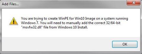

              Hi Richard,
              Thank you for your comment. I chose WINPE for Win10 and going to step 3. However, receive issue as below picture
              I am trying to download msvfw32.dll file online and add it into passmark.
              The Building process was successful. But when I try to boot up the system from the USB flash drive. It was unable to boot to WinPE with message" Operation system not found".
              Could you please help? Thank you
                I don't have access to Windows 7 machine to test, but I suggest you find a Windows 10 computer to try the install process.
