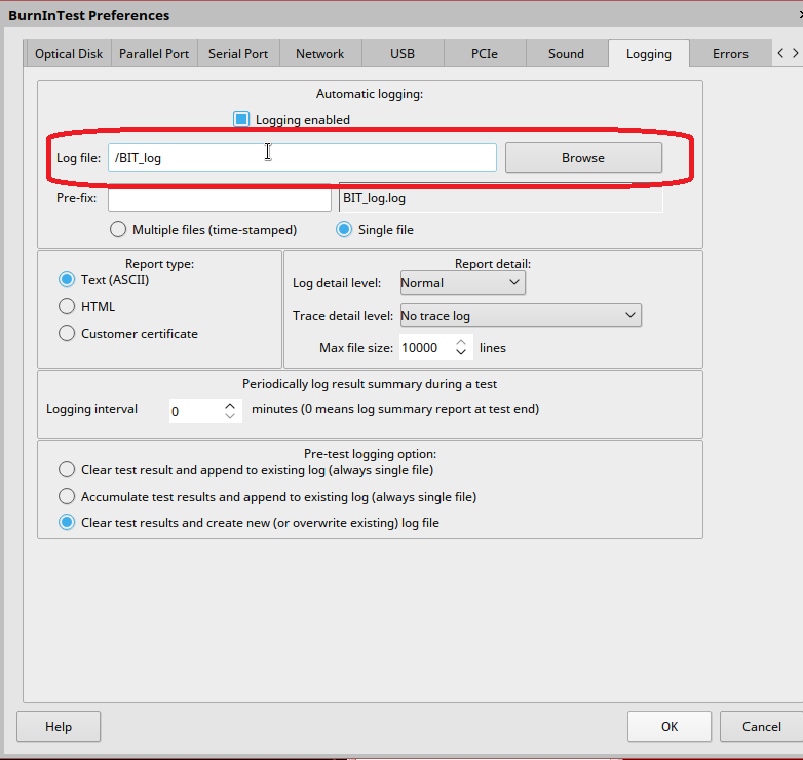

                      1. When I want to change Log File Name, I cann't only rename default name (BIT_log.log). New name isn't saved. It's need me to write full path to log file (/home/user/..../BIT_CD.log) (see .LOGName.png)
                      This is inconvenient if I want to run the test from another folder with the same config

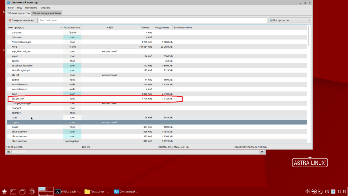

                      2. When I run bit_gui_x64 from Command line after tests I see process bit_gui_x64 in System Monitor (see System Monitor.png)
                      My command line:
                      sudo ./bit_gui_x64 -C ws-3D.cfg -D 5 -R 10
                      ws-3D.cfg in ZIP
                        1. This expects the log location to be a full path, if you want to use the current working directory then you will need to enter the log name using "./".
                        2. I believe we have reproduced the same behaviour here so we'll look into what might be causing it.
