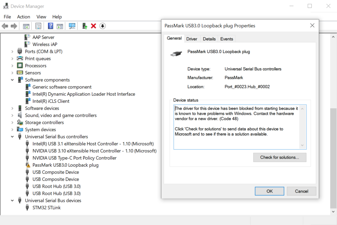

      It is likely that you have mistakenly installed the x86 version of the drivers on a 64-bit machine. Uninstalling the driver (delete) and installing the correct x64 driver should fix the issue.
      Please see the attached screenshot showing the same error when we installed the x86 version of the driver on a 64-bit machine.

        Yes, its likely due to x86 version of drivers on 64-bit machine. It fixed the issue! Thanks for quick help!
