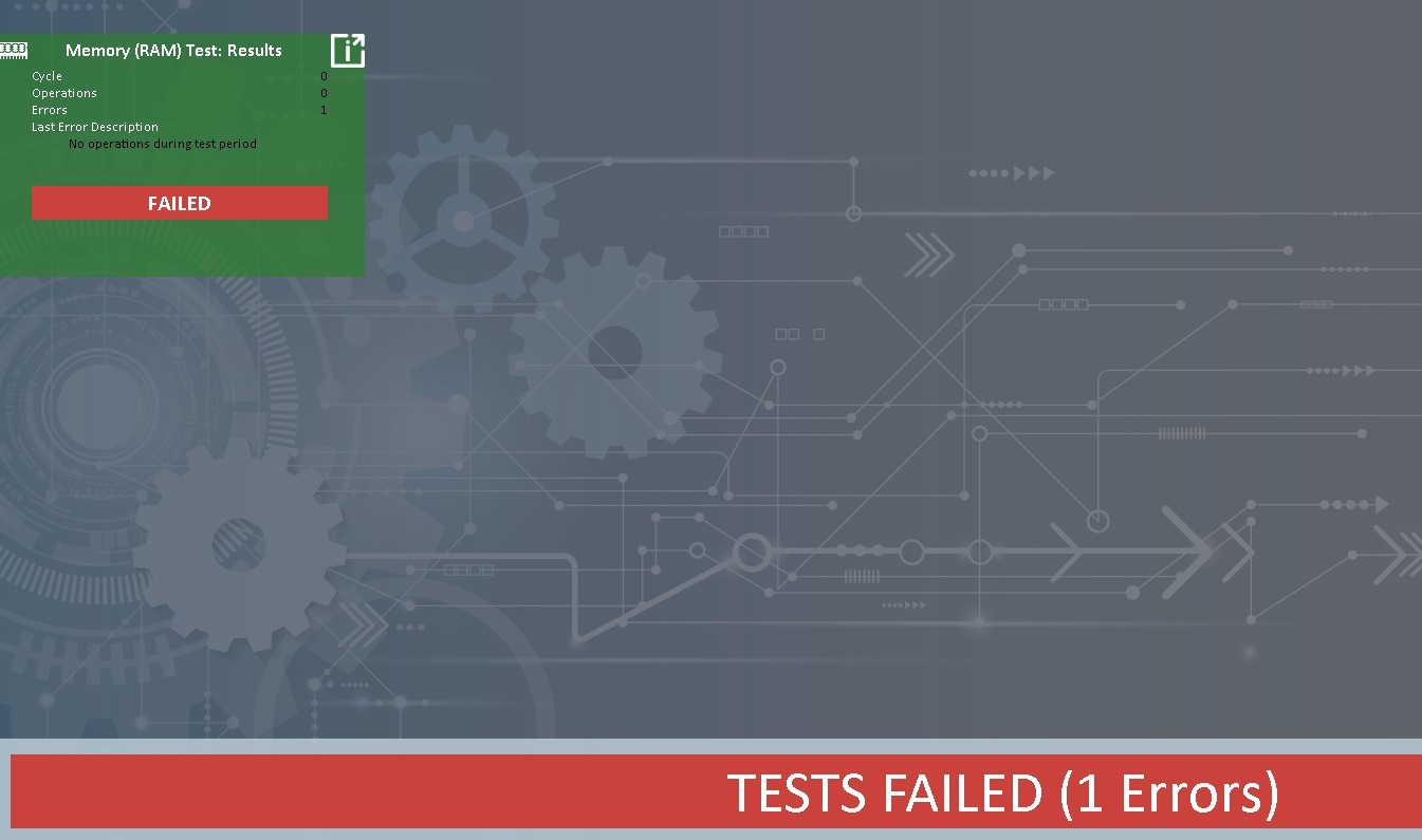

    i face a strange behaviour problem with my pc.
    It is based on amd 3900x,asrock x570 steel legend,32 gb of ram.
    I have some audio dropouts and sometimes my main working program freezes(cubase) .This is a behaviour that i have the last month.The previous 9 months i was working without problems.
    Although i was able to run ''max gpu test'' and 3 minute test '' with success,i couldn't run the cpu coverage and ram test.
    i got the message 'no perations during test period error''.i attached an image of it.
    2 days ago i run also memtest86 from a usb stick and the system restarted.I don't know exactly what time it restarted cause i left it all night working but i know that the first 1-1:30 hour it was working fine.
    what do you suggest me to do?Any idea for my problem?how can i identify if it is a motherboard,cpu or power supply problem?
    Why i cannot run those tests?
    thanks in advance

      ok i ll do it.here are some more details-facts regarding my pc behaviour:
      - I run this cpu test cpux[dot]net and the pc restarted after 3-4 minutes running it.
      i also geti this message in event viewer:
      A corrected hardware error has occurred.
      Reported by component: Processor Core
      Error Source: Unknown Error Source
      Error Type: Bus/Interconnect Error
      Processor APIC ID: 0
      The details view of this entry contains further information.
