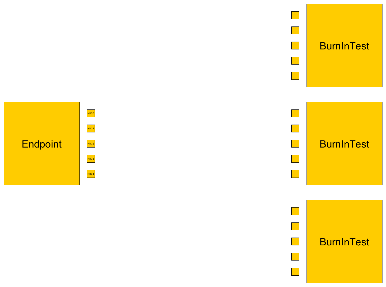

          I will summarize how I understand your setup (which I'll refer to as case A):
          • two identical machines with 5 network interface cards (NICs) in each one
          • one is running BurnInTest (the BIT machine)
          • one is running Endpoint (the ED machine)
          • with the each NIC on the BIT machine being directly connected to a NIC on the ED machine
          Could you provide some logs or screenshots of the types of errors you're receiving?

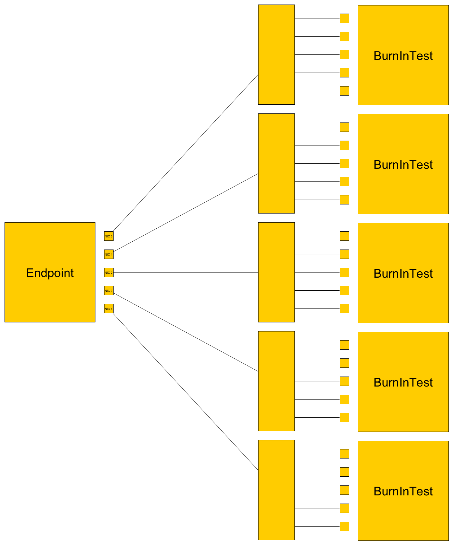

              I'm going to repeat what I understand your current problem to be:
              With the following configuration
              • One Endpoint machine with 5 NICS
              • Each of which is connected to its own switch (making a total of five switches)
              • And of each of the five switches having five connections to each of the five BurnInTest machines
              The problem is that you:
              • start a short test on BurnInTest machine 0
              • switch the KVM to BurinInTest machine 1 to start testing it
              • when the test on BurnInTest machine 0 finishes it terminates the test on machine 1
              Is this correct?
