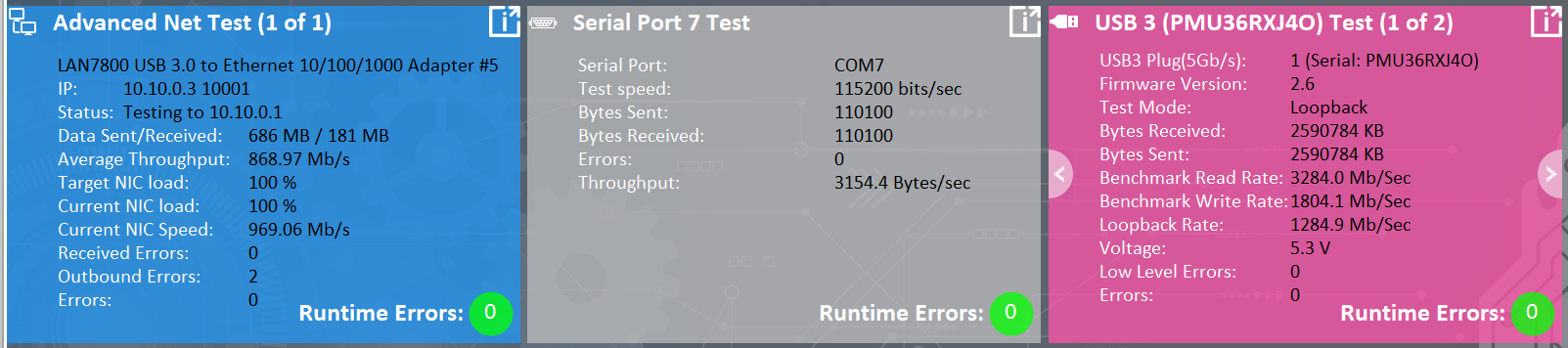

    I have been trying to write an automated test to check that Serial Ports, USB 3, and Ethernet work and are obtaining sufficient average performance over a time period. (For Ethernet, I want to capture "Average Throughput", for Serial, I want to capture"Bytes Received" and "Throughput", and for USB I want to capture"Bytes Received" and "Loopback Rate".)

    I have tried, per the documentation, to use the SETLOG command with SPEEDS=YES, but when I look at the resulting logs, I do not see any mention of the speeds I am hoping to capture.
    Is there any way to do this?

      Sure. Here it is:
      SETLOG LOG YES TIME YES REPORT TEXT LOGLEVEL YES TRACELEVEL A2 SPEEDS YES
      LOAD "path-to-config-file\_main.bitcfg"
      RUN CONFIG
      My config file consists of the three tests I mentioned in the OP. Is logging supposed to report throughput speeds? I wasn't sure based on what the documentation said for the option description: "Include speeds".​
        • 335
        Can you check that the bitcfg has the 'include speeds' option is enabled as loading the config after the SETLOG overwrites the settings there. Or swap the SETLOG and LOAD lines around.
        Note the 'include speeds' option currently only displays the speeds for USB loopback plugs (Read/Write/Loopback) and Disks (Read/Write)
        We'll look at adding more speed info for other tests in a future release.

          Thank you! I am seeing speeds for USB now. If speeds for other tests are added in the future that would be very useful.
