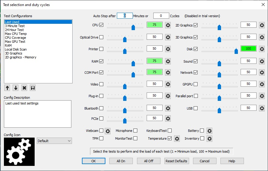

          By lower the loading , attached setting for test loading screenshot
          Could you share the setting loading what you suggest?
            • 969
            For long duration testing it is not surprisingly to see a single 3D failure. This could be as simple as the monitor turning off or some screen popup that interrupts the 3D test. BurnInTest just reports when running the 3D test, the device was removed/lost. BurnInTest will start the test again after a duration and if it is able to acquire the device, then the test resumes.
            Did you try running the 3D test by itself?
            https://www.passmark.com/support/bur...uty_cycles.php
