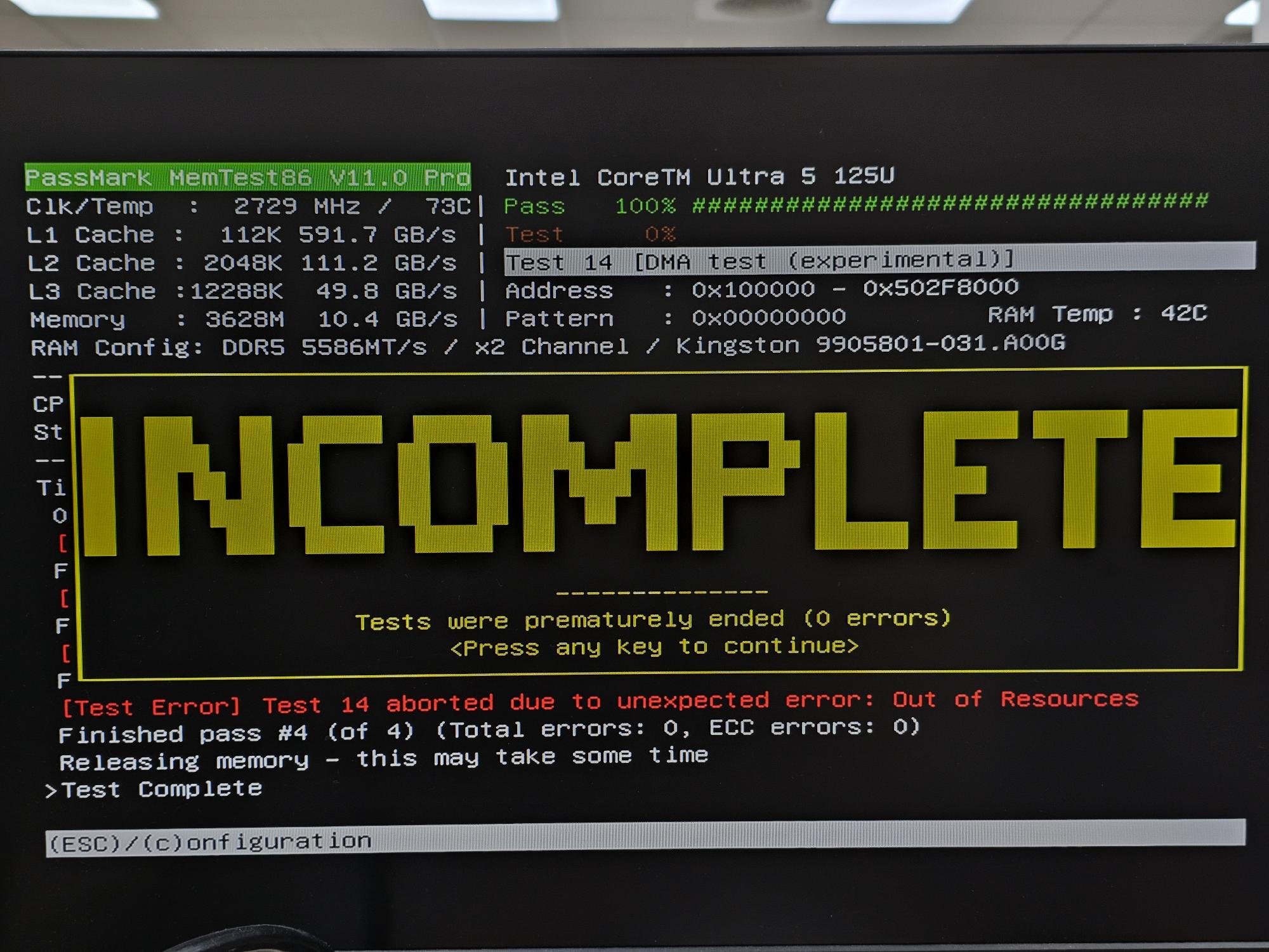

      I try to run DMA test in MemTest86 but its show "Unexpected error: out of Resources",
      please see attach file.
      Is running DMA test need to adjust some BIOS settings?
      MemTest86 ver.: V11.0 Pro
      Test DDR:
      Kingston KVR56S46BS6-8 /8G /5600
      PAITRIOT PSD516G560081S /16G /5600
        What USB flash drive are you using?
        Does this happen if you use another brand of USB flash drive?
        Does this happen if you run the same test on a system with a different motherboard vendor?
        I suspect the issue is likely with a bug in the UEFI BIOS disk controller driver. So I might check to see if there is a BIOS update.
        Also can you attach a copy of the MemTest86 logs under EFI\BOOT\ of the USB flash drive.

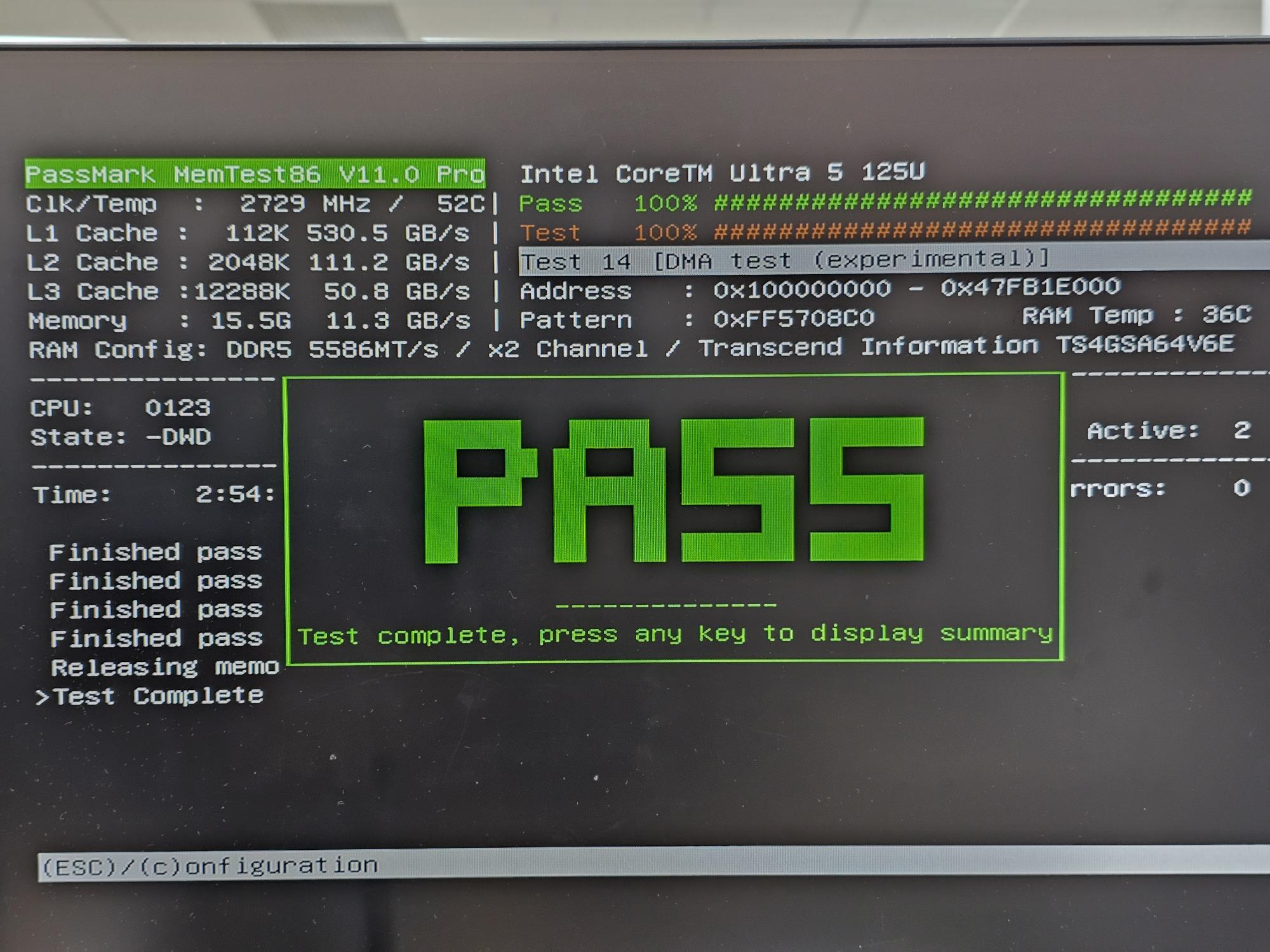

          We find a solution to run DMA test, and result shows PASS.
          But it's need "disable ALL e-cores".
          Is this is the right solution?
          do you have other recommand?

            • PeterSung
              • Oct 2024
              Dear David and Keith,
              We test DMA on CRB will cause same situation,
              we'll try another solution to solve Burn-in test issue.
              Thanks for your help and suggustion.
