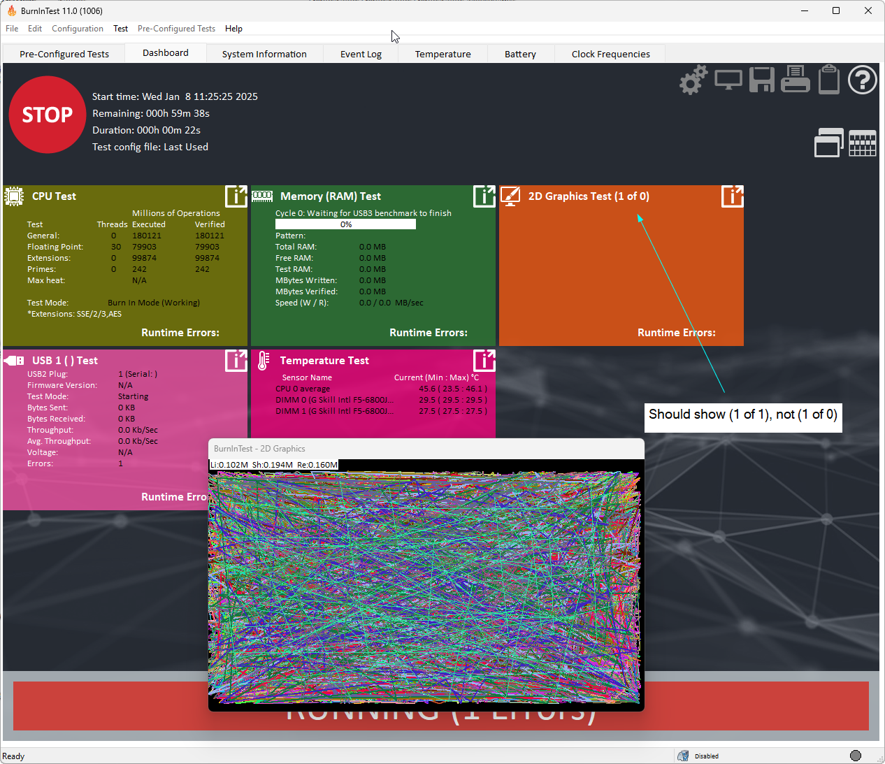

    1. On the 2D Graphics test, if I select Monitor Test and Test This Monitor, when the test is running it will show 2D Graphics Test (1 of 0). Should be showing 2D Graphics Test (1 of 1). If you go back in the Config for it and select Local video memory (GPU, RAM) then run the Test, stop test then reselect Monitor Test then run the test again it will show correctly (2D Graphics Test (1 of 1), instead of (1 of 0). This happens in both Windows and Windows PE. Have Attached Screenshot.
    The '(1 of 1)' should not really be appearing when using Monitor Test option, this will be fixed in new build and add some basic cycle/operation count info to the tile as well.
