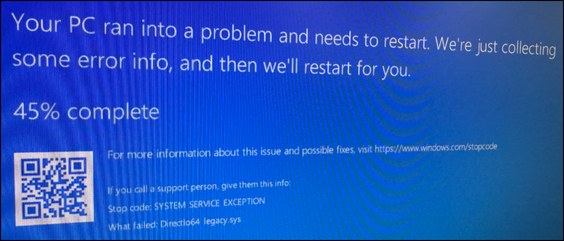

              Hi Simon (PassMark),
              Thanks for your support.
              I have tried the debug Build. However it easily happens the BSoD​ as below.
              In some cases, the error screen shows up after opening the program, before any test is executed.
              The environment is as below.
              Platform: Intel® Xeon® D-1746TER Processor​​​
              OS: Windows Server 2019 build 1809
              I also tried to re-install a clean OS. It can also meet the error.
                #22
                Pretty sure this is not related to the USB changes.
                Can you post a debug log (or EMail it to us)
                https://www.passmark.com/support/bitdebug.php
                  Can you give this build a try:
                  https://www.passmark.com/downloads/t...dbg_250618.exe
