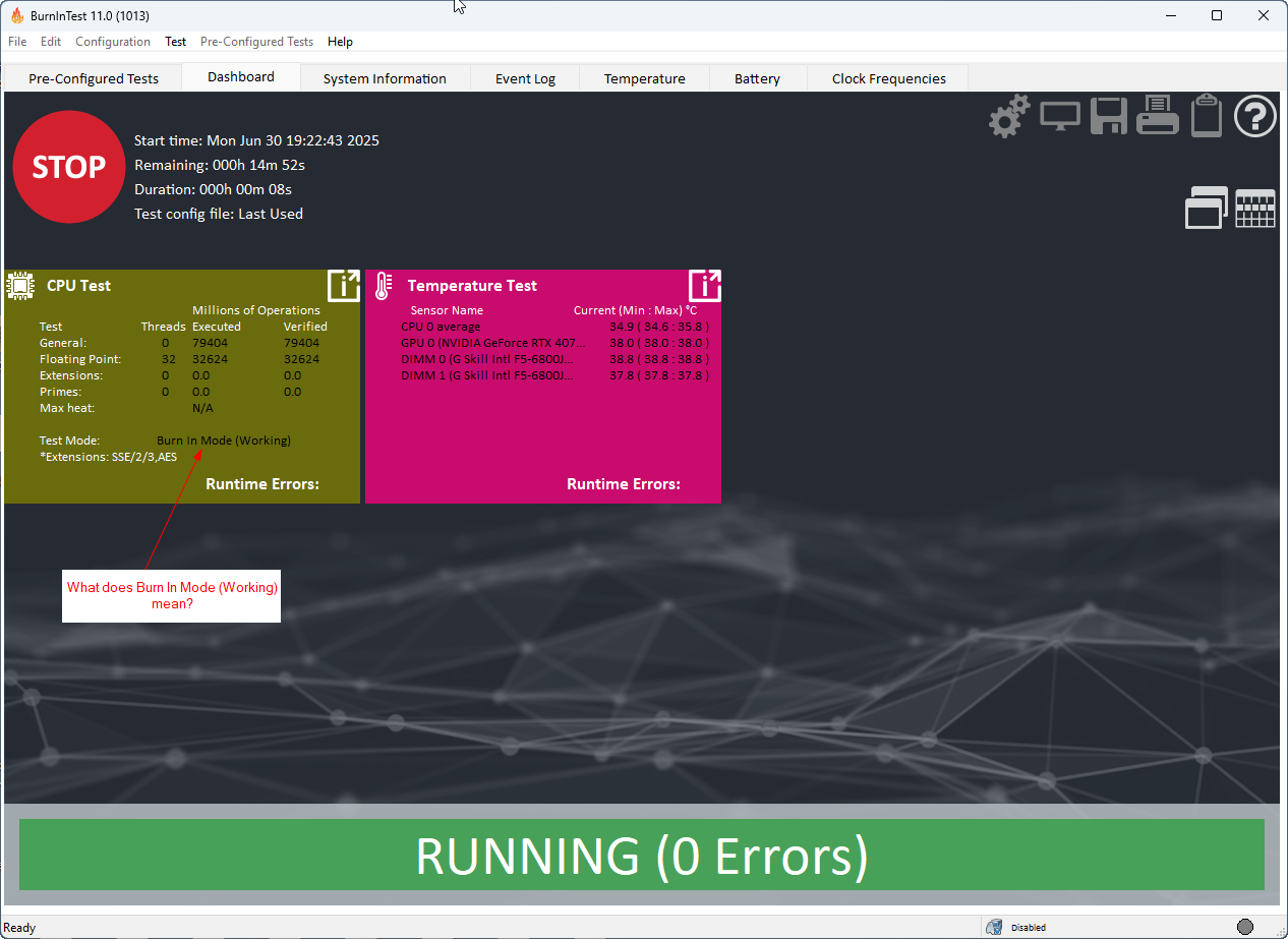

    I notice that when testing the CPU it shows "Burn In Mode (Working)". What is that supposed to mean? Not doing Max Heat, just default settings on CPU test. Have attached screenshot.
    • 335
    Indicates CPU test is running as standard/default - it can change to 'Fixed Work Per Unit Time' if option is enabled in Battery Test (Battery Life Testing > Enable testing with constant work per unit time):

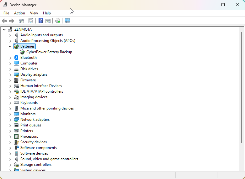

            Do you have a battery device shown in the Battery category of Device Manager? If your UPS is not listed, then it likely won't get detected.
            BurnInTest uses Windows API, GetSystemPowerStatus, to determine if the system is running on battery or have battery installed. If Windows reports that a battery is available, then it will enumerate the batteries on the system.
            You can run BurnInTest in debug mode and send in the logs, it may indicate which step the battery detection is failing for system.
            • zenmota
              • Sep 2014
              • 216
              It's showing in Device Manager. See Screenshot. I attached a zip file with everything the debug mode made.

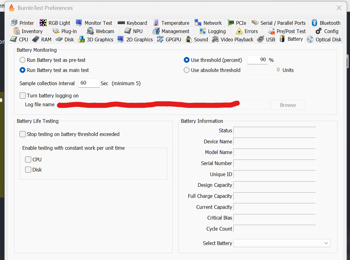

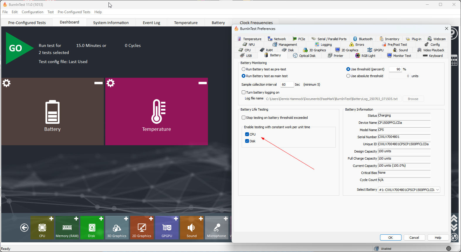

                        One question, what does Enable Testing With Constant Work Per Unit Time do (nothing in Help File I could find)? Seems if I uncheck both, run Battery Test then go back and look at it, both will be checked (even though I unchecked both). If I only check CPU run test go back look at it, both or checked again. If only check Disk, run test and go back and look at it, only Disk is checked.
                          The default behavior of BurnInTest is to do as much work as possible (depending on limits imposed by the duty cycle setting and the hardware).
                          So as en example, a Xeon CPU with 200 CPU cores would do many more calculations per second that a Laptop CPU with 2 cores. It would also use more electrical power.
                          Setting Constant Work Per Unit Time changes the behavior of BIT to do a constant number of calculation per second (or constant MB/s for the disk, etc..).
                          Having Constant Work Per Unit Time allow for better comparison of battery capacity and power usage of a system. That is to say it can be used to calculate the electrical efficiency of a system. Which in turn defines how long a battery will last when doing the same amount of work.

                            Any info on the Enable Testing With Constant Work Per Unit Time in the Battery Test where if I uncheck both, run Battery Test then go back and look at it, both will be checked (even though I unchecked both). If I only check CPU run test go back look at it, both or checked again. If only check Disk, run test and go back and look at it, only Disk is checked.
                            Thanks for all the info. Not too worried about the Battery Test in Windows with a UPS/Desktop system. Seems to me the Battery Test is more for Laptops.
                              It is in the help file. Just not very well linked.
                              Yes, we did have laptop battery testing in mind when we added this feature.
