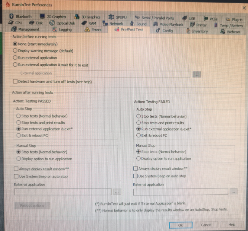

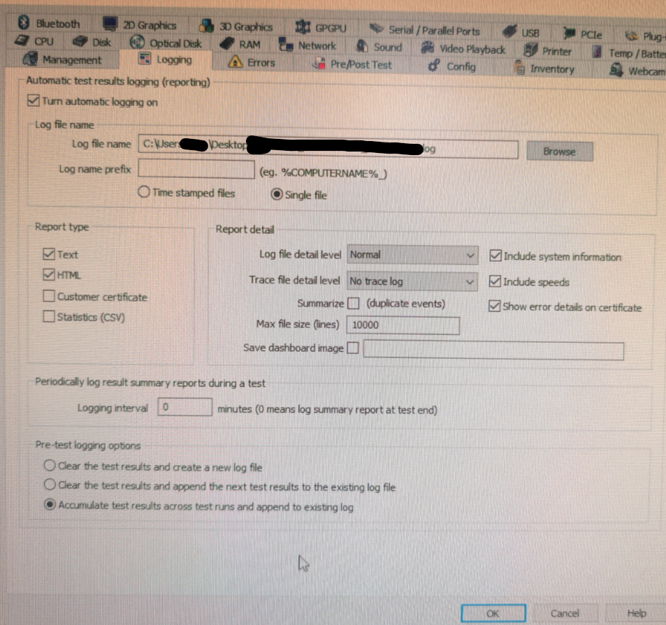

      Hi
      the maschine starts a .bat file after boot and one line starts burnin like following:
      call "C:\Program Files\BurnInTest\bit.exe" -r -LV
      BurnIn is configured like following:
      ​Click image for larger version  Name:	image.png Views:	0 Size:	1.38 MB ID:	59589​
      Click image for larger version  Name:	image.png Views:	0 Size:	1.05 MB ID:	59588​
      After the end of BurnIn (e.g. 5min testduration) BurnIn ends and closed itself (as it should do) and the script performs an reboot.
      The reboot is done with an reboot script that is tested very well and the reboot itself is without any issue.
      BurnInV10.2 is all good, no issue, testcycles/testduration/etc is accumulated across the testruns, but not in BurnInV11 (tested in Win10 and Win11)
      If you need more information just let me know,
      thanks in advance,
      BR, =)

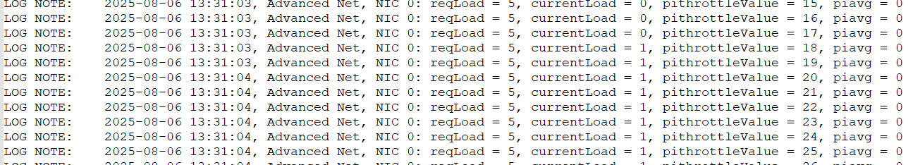

          i have one more question, would it also be possible to integrate the option to disable the advanced network information note inside the logfile? Or is there already an option for this and possibly i have not found it.
          the logfiles gets very big now and need a lot more space to store them.
          Thanks in advance and
          BR =)
            Those are debugging information entries. Those lines should only be visible in the logs when you have Trace Activity set to level 2 (or running in debug logging enabled).

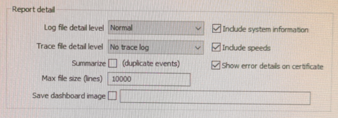

                my settings was like in the screenshot above:
                since you have already reproduced the issue, im waiting for the next build update.
