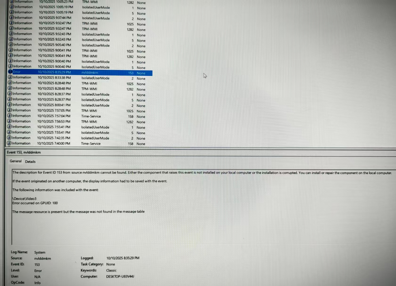

      when error happend, there is error in windows event log as below
        Error was nvlddmkm Event id 153
        nvlddmkm​ is the nVidia device driver. Seems it crashed.
        I Googled it for you.
        There are a few reports of the same issue with various software.
        https://www.reddit.com/r/PcBuildHelp...errors_on_new/
        https://learn.microsoft.com/en-us/an...d-153-nvlddmkm
        https://www.reddit.com/r/techsupport...3_from_source/
        https://www.nvidia.com/en-us/geforce...hes-event-153/
        The posts above offer various solutions. Including switching to an old driver version, fixing power supply issues & disabling Nvidia Audio.

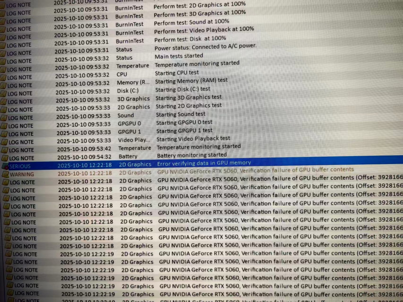

          Hi David,
          I have try BurnIn Test V11, above GPGPU fail is disappeared, but happend one time 2D fail as below, and if use v10.2 to run GPGPU test only for 24 hours, there is no error happen
            With version 10 you were probably using the older DirectX V9 3D test (Planes flying a loop).
            With version 11 you were probably using the newer DirectX V12 3D test (Space battle).
            So getting different behavior isn't so surprising.
            But the verification failure of GPU buffer contents error might be a real video RAM failure. Do you have another 5060 to test with to see if you get the same behavior?
            • dqa_minisforum
              • Nov 2024
              • 16
              Hi David,
              Yes, I have replaced another RTX5060 to test, the failure still can be duplicated, and i replaced a new ATX PSU to test, the failure is the same,it confused me right now.
