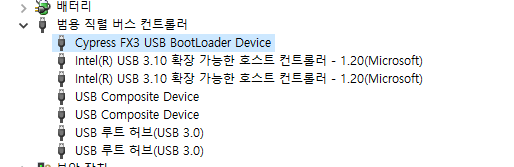

    I can see "Cypress USB Bootloader" at Device Manager.
    Can I get solutions to solve this issue?

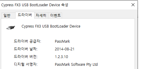

    If it is recognized as "Cypress FX3 Bootloader Device", it means the firmware is wiped out. Whatever reason, perhaps the firmware upgrade didn't take. Can you please try reinstalling the device driver and run the updater again?

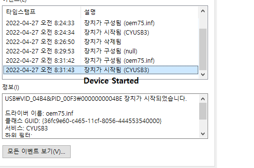

      Thanks for your reply.
      I tried several times to reinstall the device driver and change PC to solve this error and device but all devices have same error again.
      Can I get other solution?
