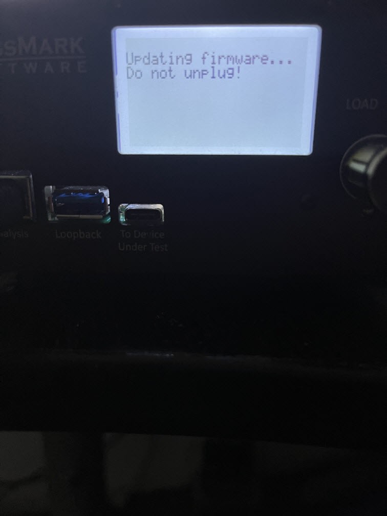

    PM125 Bricked After Firmware Update
    I agreed the firmware update request from the "USB Power Delivery Test" App and then my PM125 kept showing "Updating firmware... Do not unplug! on the LCD screen.

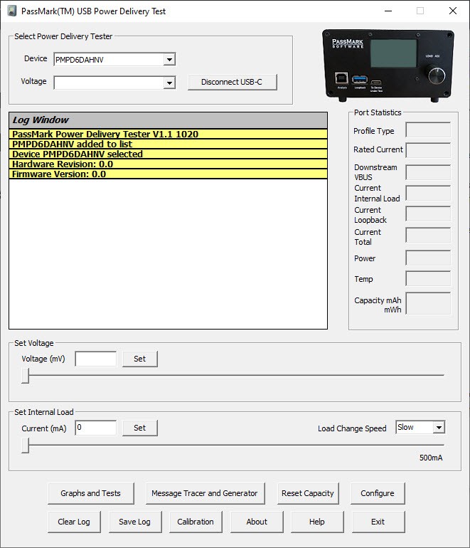

    I ran USBPD_FWupdater.exe and selected device model to PM125 to reinstall the firmware but I still failed to fix the firmware issue.
    I ran "Power Delivery Test" App after running USBPD_FWupdater.exe and it showed both hardware and firmware revision were 0.0.

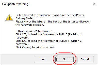

      1. Running the updater software and clicked 'No' button to install PM125 FW (see the attached).

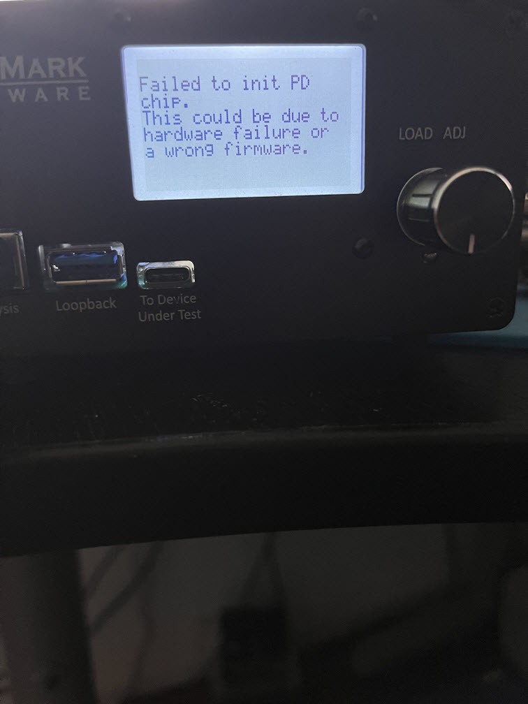

      3. Plugged the USB cable again and PM125 LCD screen displayed 'Invalid Firmware Bootloader running' message.
      3. Run the updater again and clicked 'No'.
      4. PM125 LCD screen displayed 'Failed to init PD chip. This could be due to hardware failure or wrong firmware' after the FW updating counting to 100%.
      5. Then PM125 screen kept displaying 'Updating firmware ... Do not unplug!'.

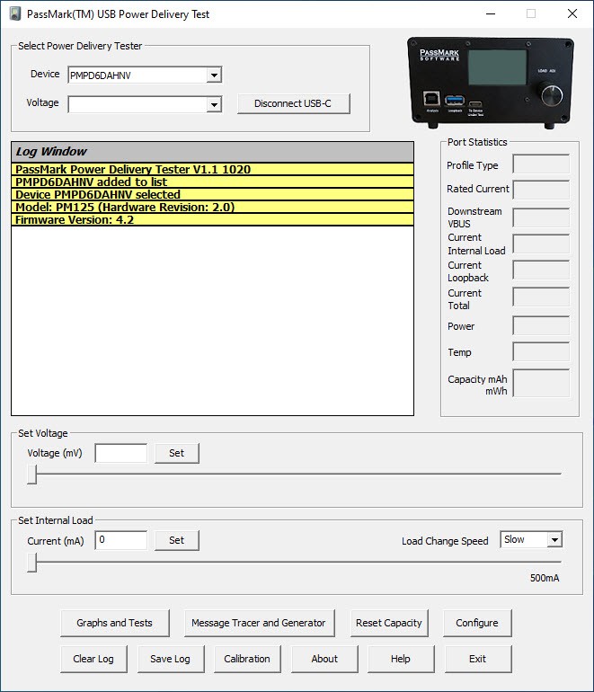

        By updating the FW many times, I got some chances to see the PM125 screen displayed 'Waiting for Device Under Test'.
        I ran the 'USB Power Delivery Test' app and I could get the correct information about hardware and firmware revision (see attached) but PM125 had no any response when I plugged in the USB C power for test.
