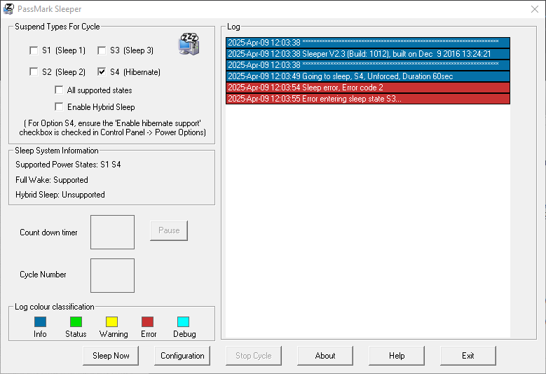

    Hello. My Windows 10 Desktop will not hibernate. It shows "Hibernating" on screen but quickly changes to saying "Locking." It sleeps fine but won't hibernate. I ran Sleeper to test the S4 Hibernate functionality, and it came back with error code 2. Any guidance is greatly appreciated. Thank you.

        If you run powercfg.exe /a is S4 (Hibernate) available on your machine? See below.
        Can you try disabling and enabling Hibernation to recreate the file. Using powercfg /h on / off.
        Sometimes there are also BIOS settings which effect what sleep states are available.
