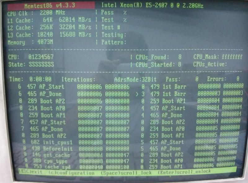

        Can you run MemTest86 with boot trace enabled by selecting the boot trace option in the menu. Continue pressing a key until you reach the trace point before the crash. Please take a picture of your screen using a digital camera and send the image back to us.
        • ferdinandwang
          • Sep 2013
          I have send the picture to you.Click image for larger version

            Thanks for the screenshot.

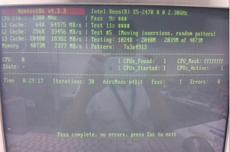

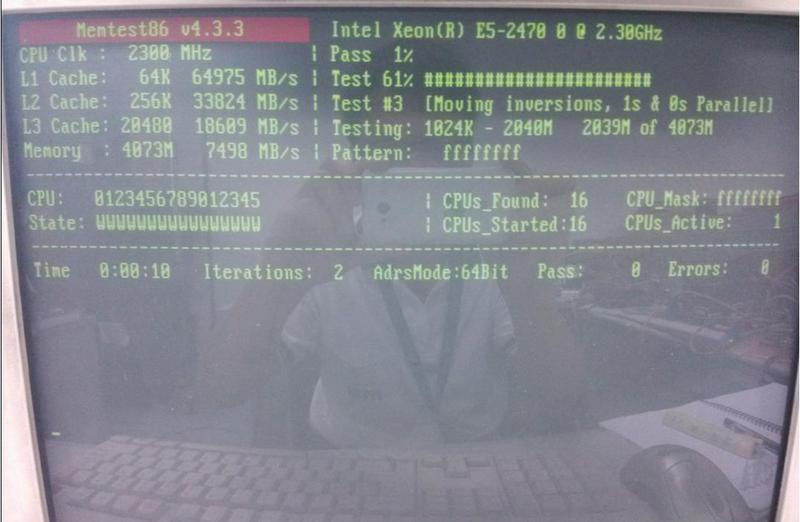

            We may have seen a similar problem before. Have you tried running with only 1 CPU enabled? If it's like what we've seen before, it should work without any problems.

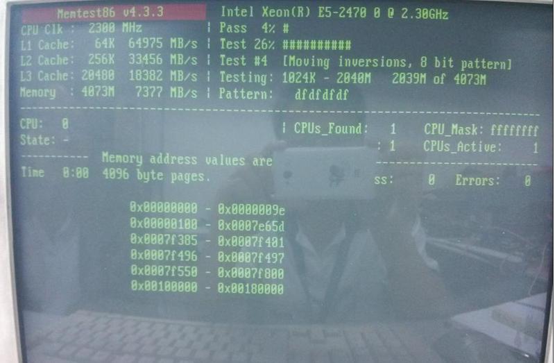

            Also, can you go to Configuration->Miscellaneous Options->Print Memory Map and take a picture of the screen.

Name:	4.3.3 one CPU enabled PASS.jpg
ID:	34840Click image for larger version
Name:	4.3.3 default mode crash.jpg
ID:	34841Click image for larger version
Name:	4.3.3 memory map.jpg
              Here attach the three pictures. we tested the 4.2.0 with default mode, and passed.

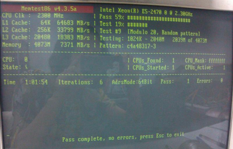

                Thanks for the screenshot. Can you try this pre-release build and see if the problem still occurs:

Name:	4.3.5a 1 CPU pass.jpg
                  One CPU pass. SUT reboots with default mode every times.
                    Looking more closely at your screen shots it looks like you switched to a new machine between some of your posts? Some posts have a E5-2407 CPU and some other screen shots show a E5-2470.
