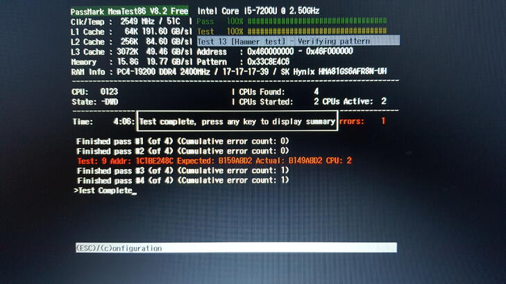

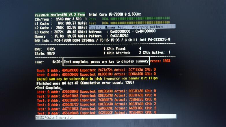

    just used the excellent MemTest86 on my laptop Acer E5 (i5-7200U @ 2.50GHz) with 16GB RAM installed. After had again a "memory management" blue screen on Windows 10, I've decided to run memory tests.
    Although, results are bit confusing, that's why I'm trying to get your support here.
    1. 1st test on both RAM modules installed reported 1393 errors!
    2. 2nd test on one RAM module only (SK hynix) reported 0 errors.
    3. 3rd test on other RAM module only (G.SKILL) reported 0 errors.
    4. Installed both RAM modules again but swapped position reported 1 error.

    Can you return the RAM to it's original position and retest. There might be slight timing / voltage differences between the slots.
    Re-seating the RAM might have also cleaned up the connectors. So it might already be mostly fixed. Even a single RAM error is enough to crash the machine however if you are unlucky.
