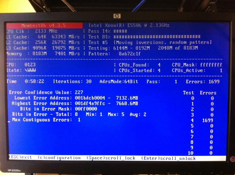

    I've run a test on a Supermicro with Intel Xeon E5506 and 8 GB RAM.
    An error came up during the second pass. See attached photo.
    Why does it not tell me which bank is at fault?
    Thanks,
    Cees.
    • 11127
    Normally it isn't possible to know which slot has an error, except by trial and error. The problems are
    - that that the slots aren't labelled in general, so you don't know which one is slot 0 for example.
    - the bytes are spread across the sticks when using dual, tri or quad channel RAM.
    So the best option is to test one stick of RAM at a time. (or test pairs at the same time if you had 4 sticks installed)
