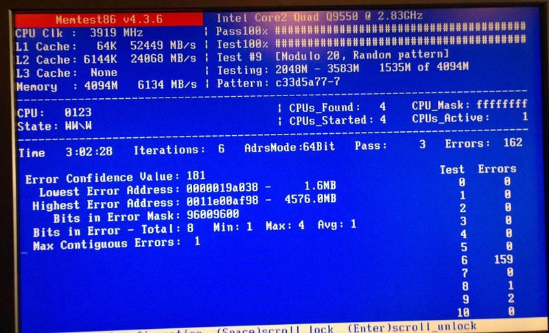

    This system has lately been boot looping for unknown reasons... at least twice lately.
    Q9550, Gigabyte GA-EP45-UD3P board, 2X2GB Corsair Dominator TWIN2X4096-8500C5DF.

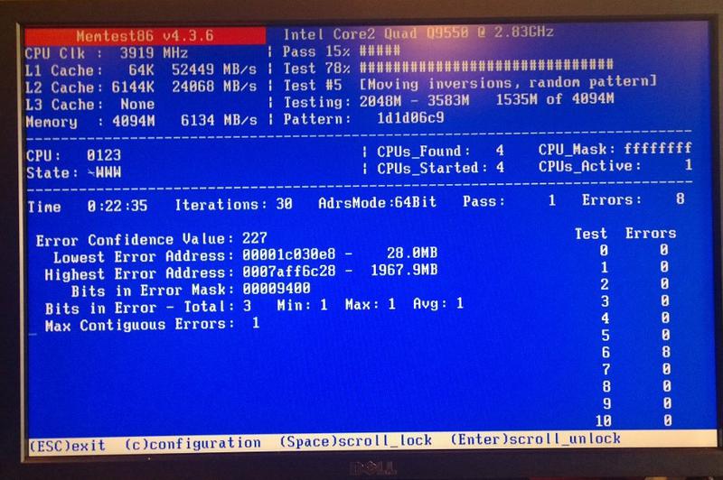

    Currently running the memtest86 and on 1st pass got a few errors on pass 6. Right now after about 1 3/4 passes - 89 errors on pass 6 and 1 on pass eight. screen shot follows.
    Thanks in advance
    • 11112
    Do you have some spare RAM to try?
    Or can you try testing 1 stick at a time?

      No extra memory but I could test one stick at a time. That would include each stick in each slot?
      Also add one error on pass 9

        Ok checked the yellow slots the memory was in (1 & 3) each stick gave no errors in either slots when tested individually. What's up with that?

                I did run a test with the two sticks in at default bios settings for one pass no errors... I am currently running a pass @ saved bios settings @ 3.91GHz. So far up to test 9 and zero errors.
                Secret answer may be the pencil eraser trick on the contacts in my case...and may post a screen shot at about 3 hour mark. I have a before and after shot of that mark
                If I say no more that worked for me at least.
                I say more I have now on pass 1, test 6, 150 errors...
                Thanks for your replies David!
                Last edited by Conners; Nov-26-2013, 10:57 PM. Reason: added 3 hour test from 1st concern.
