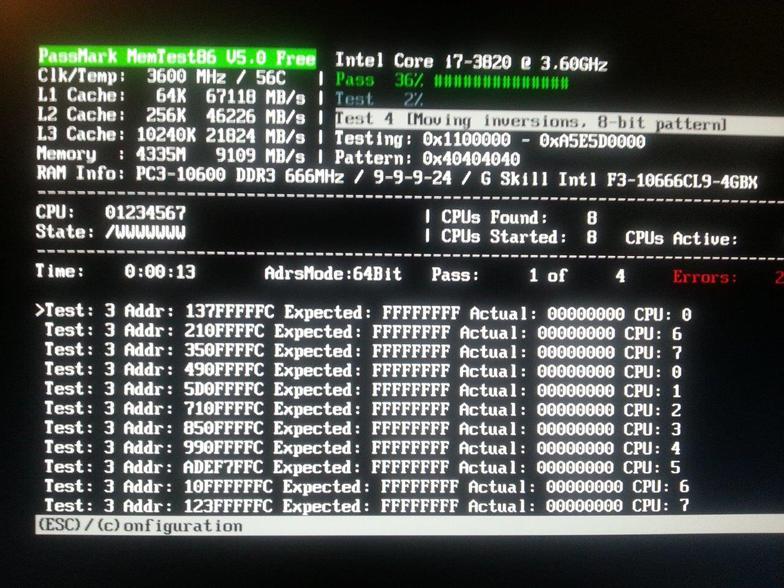

    My computer suffer from BSOD and freezes.
    I've started to test the memory with MemTest85 V5.
    I have over 2000 errors with test running in multi CPU sequential mode but no errors with single, parallel or round robin.

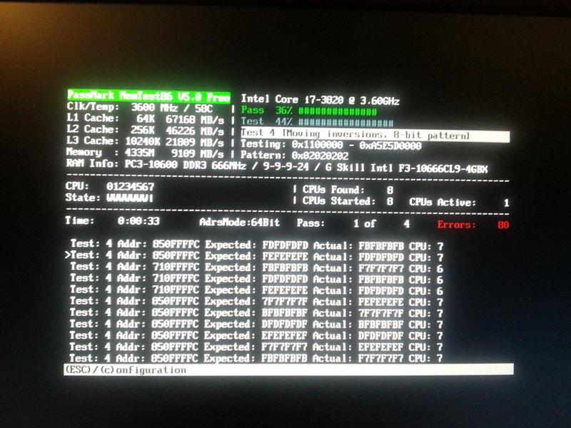

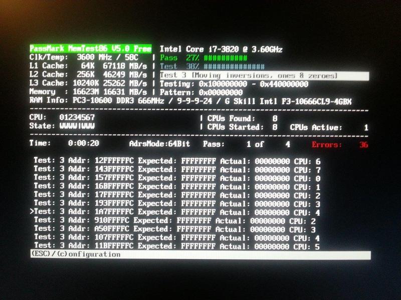

      Hi David,
      Thank you for reply. I have tried to test one kit only, also the other kit and a two single modules (only one inserted at a time). In all cases sequential gives errors, and other CPU types don't.
      Please find the enclosed screenshot.
      I will try to run the tests again and save the log files later.
      Do you think it is more likely to be memory related problem or the motherboard or the CPU? BIOS Maybe?
