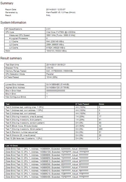

    I recently ran a 4 pass with all 10 tests active using parallel mode for the CPUs. I took a screenshot of the html file that the report was saved in, however I'm not sure not sure the best means of getting it interpreted. I can't really pinpoint what hardware is failing. Could someone help me?
    Looks like one of your RAM sticks has failed. Try testing 1 stick of RAM at a time, or just swapping it all out.

      Thank you very much! I'll try that and do some retests.
      • Benjamin
        • Aug 2014
        After successive tests, I managed to find the bad apple. Down to 12gb of DDR3 1600, now single channel, but it's better than data corruption. Thanks for the help!
