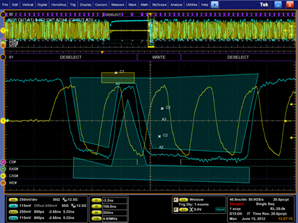

              I've never done it (play with these particular very low level settings). But I would have assumed that the correct way to do it would be to have oscilloscope connected to the memory bus. Then make fine adjustments until the waveform meets the specs.

                Nice, wish I had that capability to use an oscilloscope like that!
