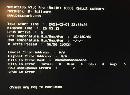

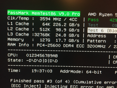

          I'm seeing the opposite with a Ryzen 5 3600. While MemTest86 V8.4 Pro reports CPU temperatures in line with my expectations, MemTest86 V9.0 Pro reports temperatures ~50℃ lower. See IMG_1 and IMG_2 (below). Note in IMG_1 that when a two-character temperature like “4C” is written to the screen, any previously written information beyond the first two characters is not overwritten by blanks. A log and additional information were emailed on February 11 to help@passmark.com with the subject line "MemTest86 V9.0 Pro Reports Incorrect CPU Temperature".
          (Independently, observe in IMG_2 that no number is displayed after “CPUs in Error :” rather than the “0” that I would expect.)
            This should be fixed for the next patch release.
            Thanks for pointing it out. This should also be fixed for the next patch release.
            CPUs in Error should report the list of CPU cores that detected memory errors. If there are no errors (such as in your case), the field should be blank. I can see how it is a bit confusing, though.
            We have fixed it so that if there are no errors, CPUs in Error will not be displayed.
