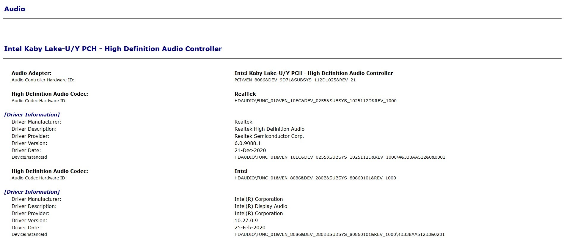

    I attached a report from HWiNFO64 v6.43-4370 / Audio section (in the hope that it helps).
    (Is this feature not supported for this hardware?)

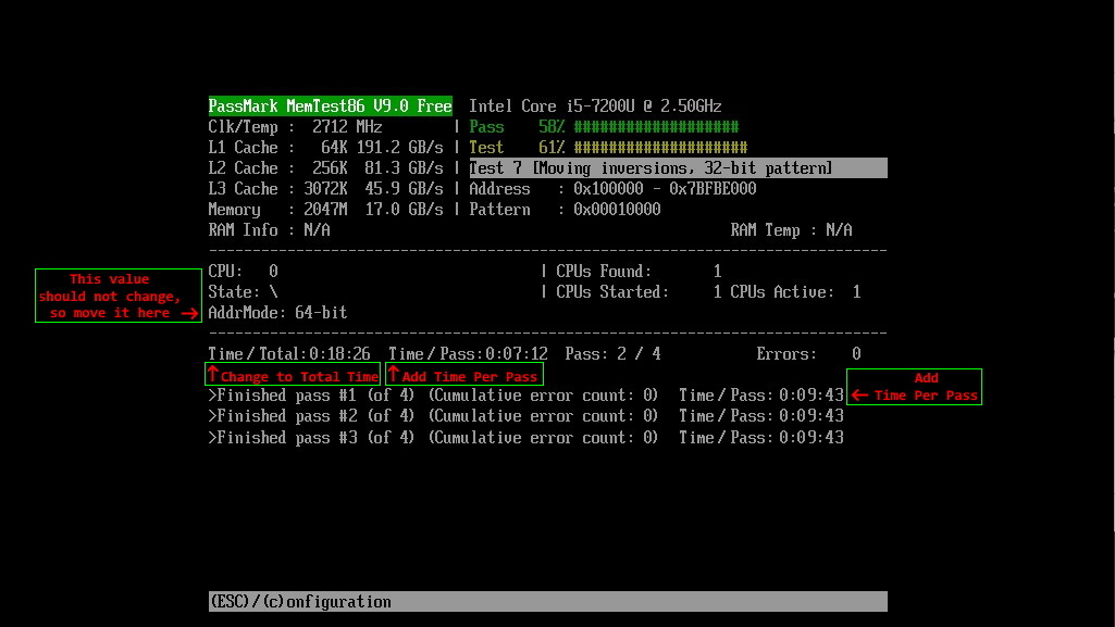

    I also attached a screen change layout suggestion.
    (Based on my patiently waiting for Passes to finish.)

    As far as we are aware there is no standard in UEFI for audio output.
    Background:
    Each audio card / chipset has a different hardware interface. In Windows this is taken care of by the audio device driver. (The function of a device driver is to provide a standard interface to the operating system and hide the complexities of the hardware). This is also part of the reason audio in Linux only works half the time. Missing or half implemented device drivers.
    But before sound cards started appearing in PC's there was another audio option, which was standardized. This was sometimes called the "PC speaker" or piezo speaker. It was used for BIOS error beep codes and a few other things. Years ago this speaker was a standard thing in nearly every PC, but it is becoming less common now.
    So as we don't want to write code (basically our own device driver) for every sound card on the market, MemTest86 is using the piezo speaker to make a beep at the end of testing. So it isn't relevant what sound card you have, as we aren't using it. But this piezo speaker will not be installed in all systems. We don't know the numbers, but I would think many laptops don't have it.
    Short version:
    Only some systems have the hardware to make a beep sound.

      Thanks for responding so quickly!
      I found this list of Acer BIOS POST codes. Perhaps this URL might help?
      http://www.bioscentral.com/postcodes/acerbios.htm
      I'm guessing there must be some basic audio mechanism present.
      If this had worked, would it have beeped after completing just one Test/Pass (if so configured)?
      BTW - Did anyone get a chance to look at my screen layout suggestion?
      (Just thought I'd ask ...)
