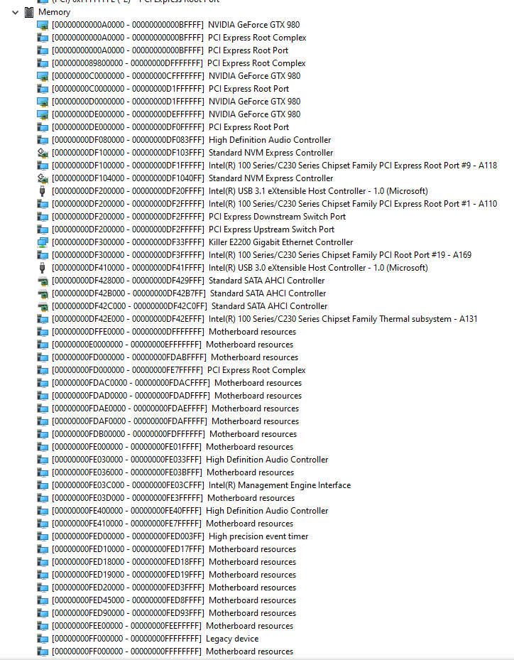

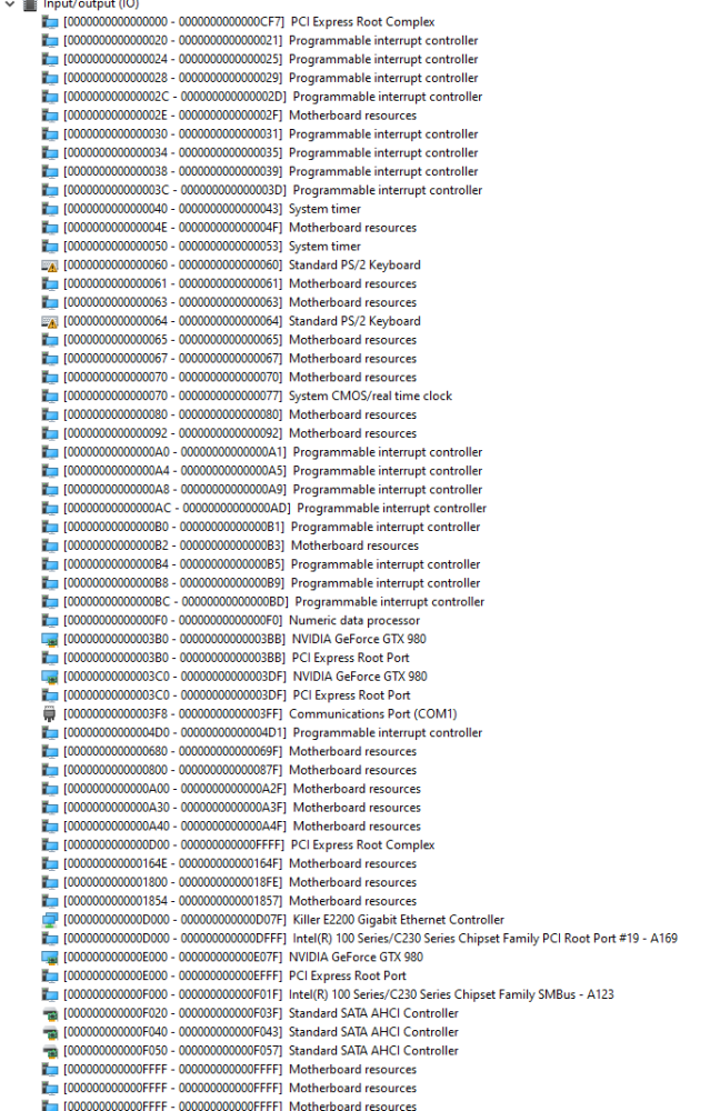

      Thanks for your response, you're right, the 1.9 GB is shown as reserved for hardware. But I agree it still seems excessive. I'm trying to check which resource is hogging all the ram by looking at address ranges in Device Manager, but I'm not familiar with reading hexdec

      If anyone could help me read these ranges it could be very helpful
        The I/O ports are relevant. So ignore them.
        For memory usage, video cards are often the large users.
        For example, GeForce GTX 280 CFFFFFFF - C0000000 = around 228MB.

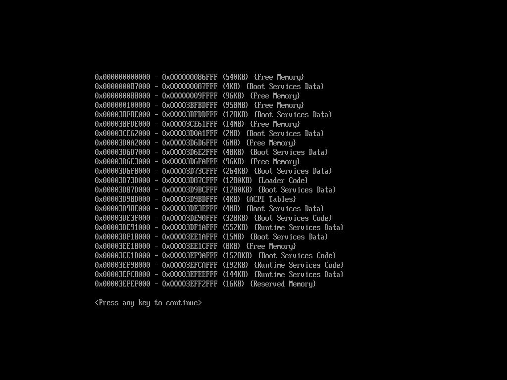

        Memtest86 itself can also display the memory map in a slightly more friendly way.
