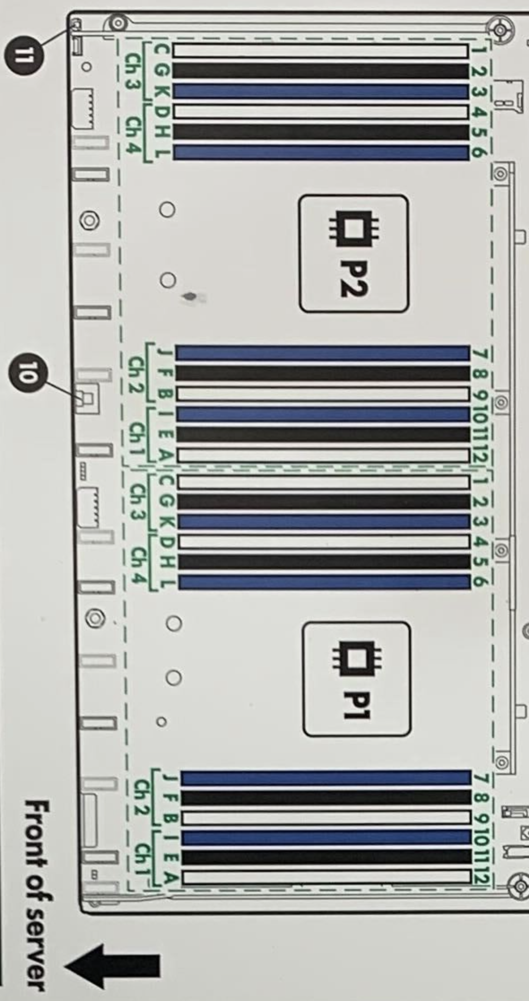

          Attached the CPU memory channel/slot for this particular server. I'm going to try and move a known DIMM with ECC errors across the board to see if I can reliably correlate the channel/slot reported to something on the board. So far I have only seen [0-7]/[0,1] reported for channel/slots. The ones with S/N have only been in CPU2 Ch3 and Ch4 and report in MemTest ECC Error log as channel 0 or 1 and slot 0 or 1

            Can you upload or send a copy of the MemTest86.log under EFI\BOOT\ of the USB flash drive.

                It may be possible to map the reported channel/slots to the physical slots on this particular board, but having multiple sticks with ECC errors makes it more challenging.
                But if you are able to isolate the errors to a single module/slot (and grab the logs for these runs) we might be able to do a proper mapping in the code.

                    Adding something interesting. I have been able to map the channels MemTest reports to the channels on the board. My issue now is that while slot 0 will always map to the first physical DIMM slot on the board, slot 1 and 2 are both being reported as slot 1 in MemTest.

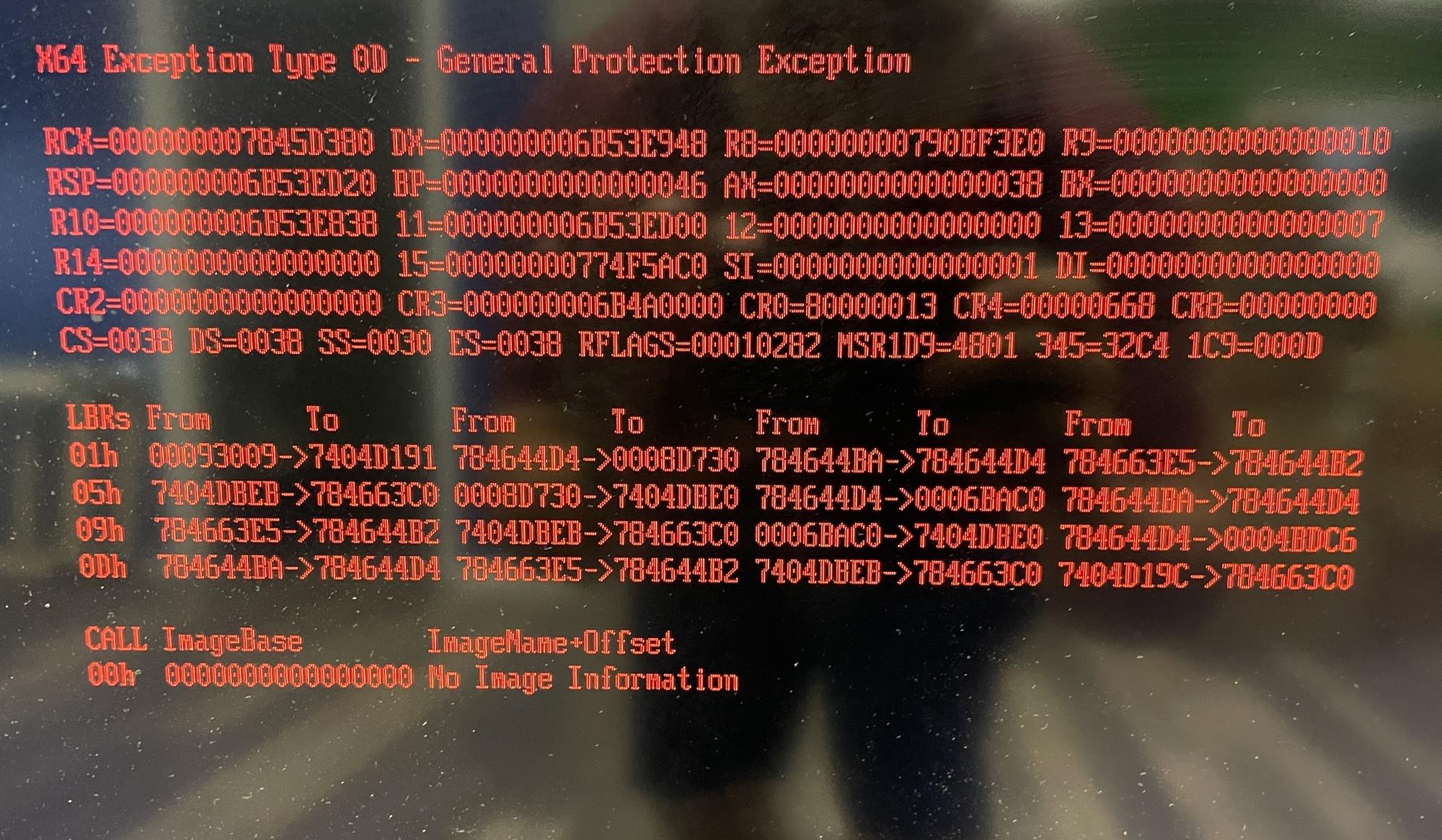

                        I wrote the supplied image out with balenaEtcher on my Mac, which I used previously for the standard release. Unfortunately this is what I see after the initial MemTest initialization.

                          Any update on a new image or what I may have done wrong?
                            We've never heard of balenaEtcher. So don't know what it does or how it works.
                            There are instructions here for making a bootable Memtest86 USB drive on Mac here.
