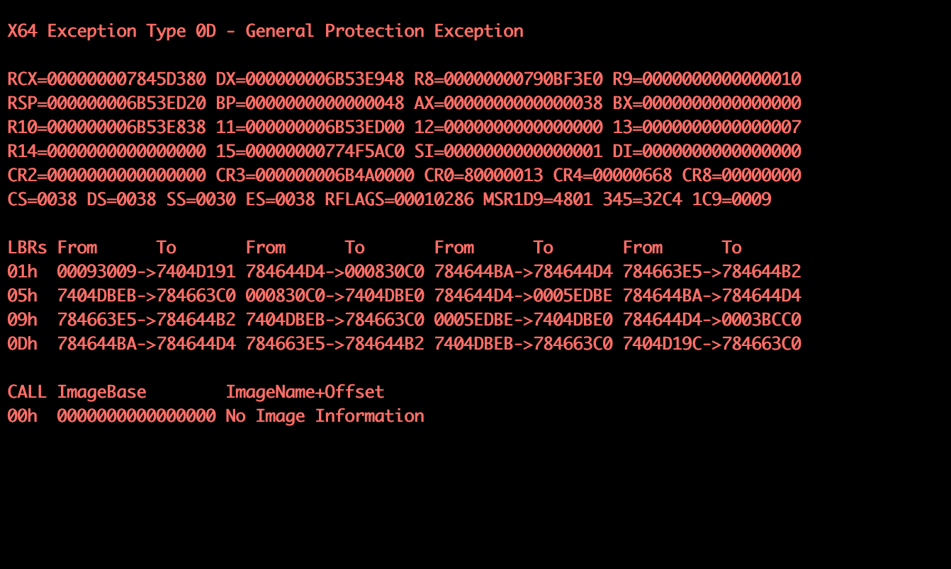

      Confirmed the sha1 matched and tried the DD method Ended up with similar results. There was a log file so including that along with the error messages.

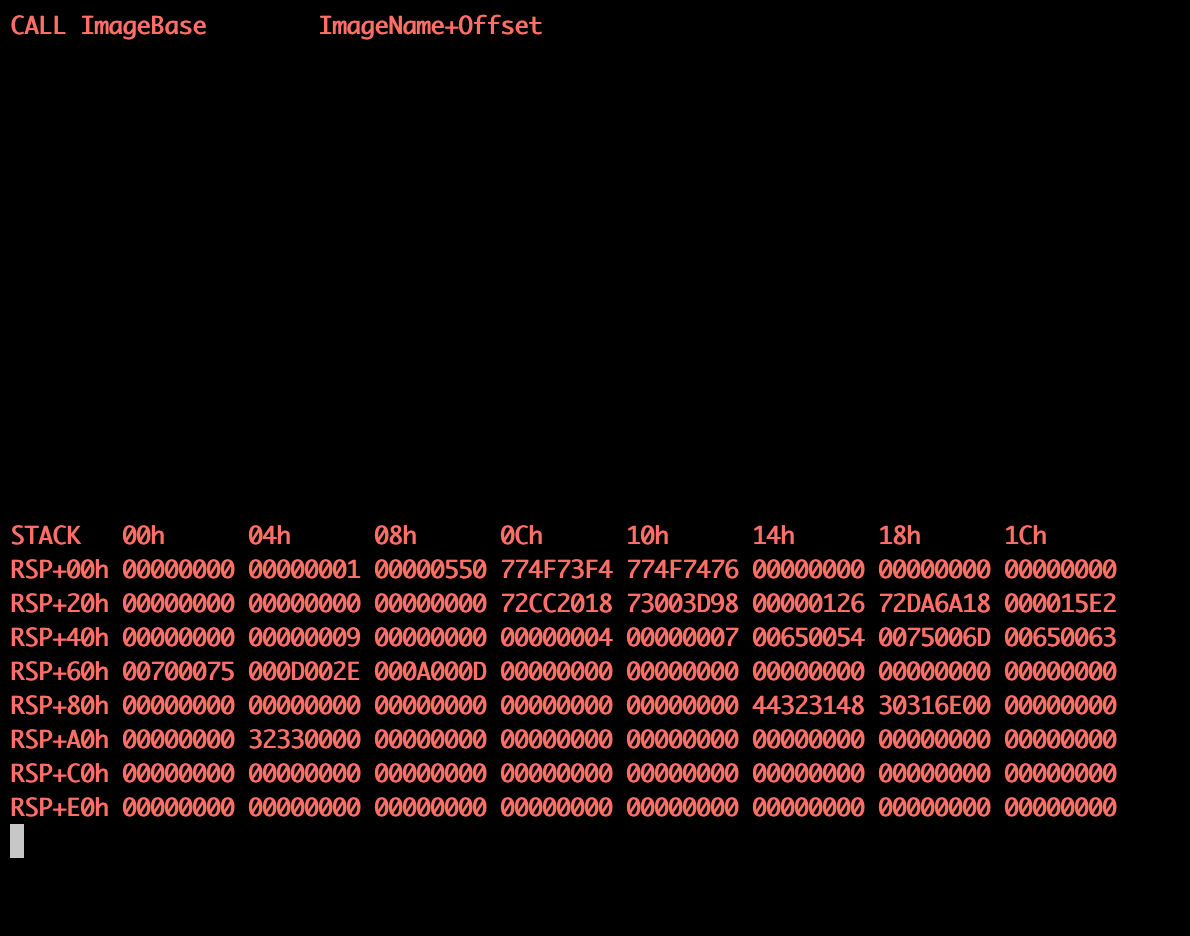

                  Unfortunately I have the same results as last time with it failing to run the test. Is there a specific mt86.cfg or any other setting I should be doing with these images?
