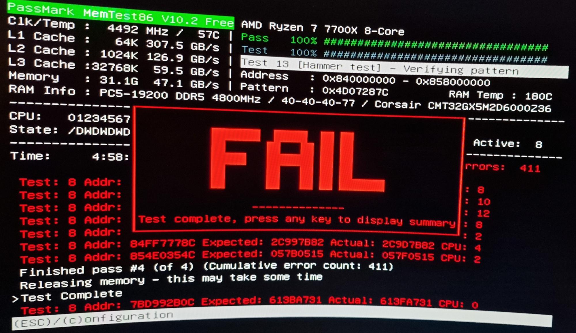

                dude you were right! Today out of desperation I had redone the ram test... and fail... 411 error... I don't know why it passed the test 3 times (2 times with each single stick and the third time with both) . I apologize for the photo but the keyboard no longer takes bios commands ... again ... it was solved and now after the reset via CMOS again ... that too ... thanks Asus ...
                  16GB is enough for most tasks.
                  Try running 1 stick at a time for a couple of days.
                  But in the end you probably need to get the RAM replaced.
