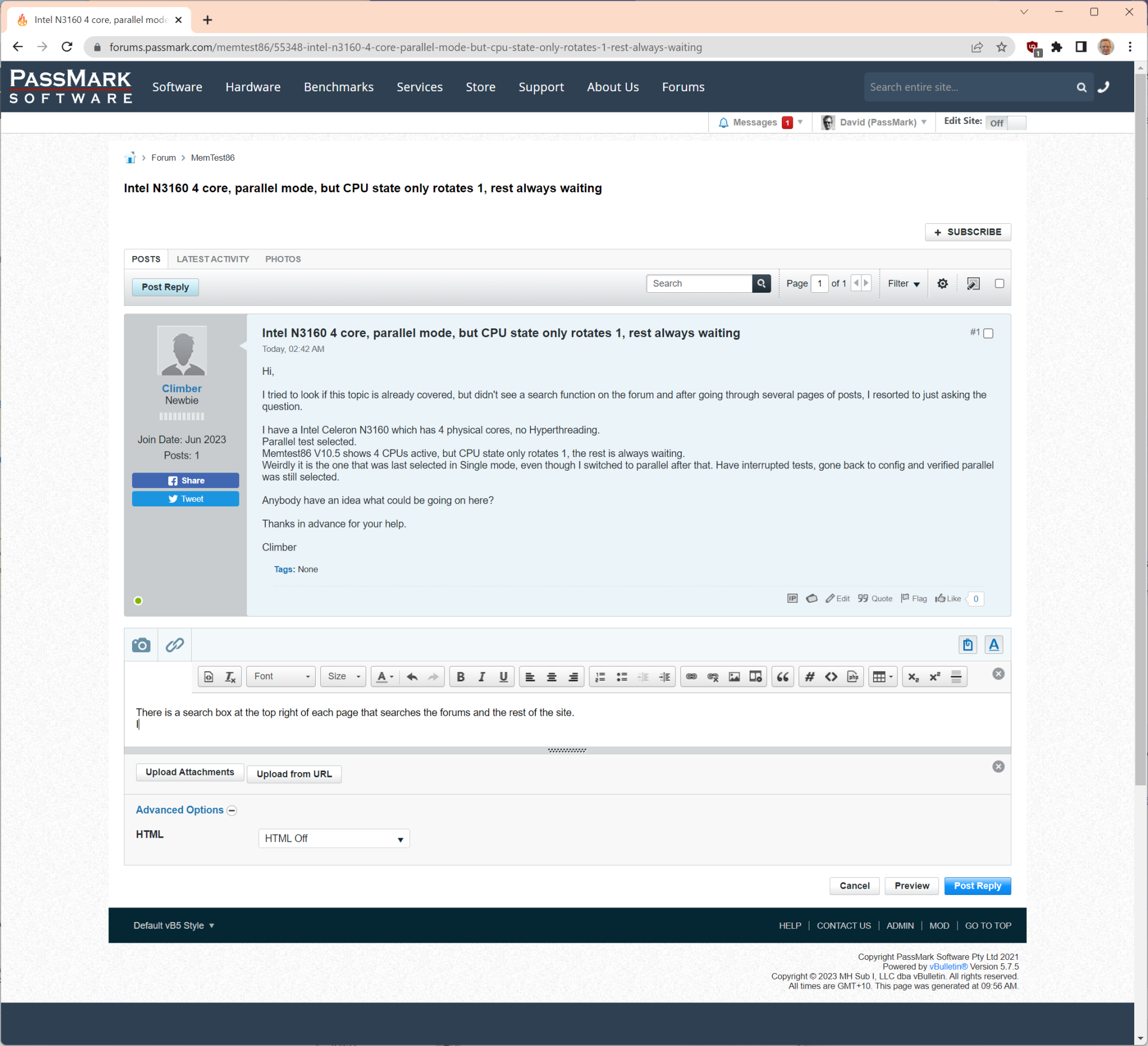

Intel N3160 4 core, parallel mode, but CPU state only rotates 1, rest always waiting
  • Climber
    • Jun 2023
    I tried to look if this topic is already covered, but didn't see a search function on the forum and after going through several pages of posts, I resorted to just asking the question.
    I have a Intel Celeron N3160 which has 4 physical cores, no Hyperthreading.
    Parallel test selected.
    Memtest86 V10.5 shows 4 CPUs active, but CPU state only rotates 1, the rest is always waiting.
    Weirdly it is the one that was last selected in Single mode, even though I switched to parallel after that. Have interrupted tests, gone back to config and verified parallel was still selected.
    Anybody have an idea what could be going on here?
    Thanks in advance for your help.

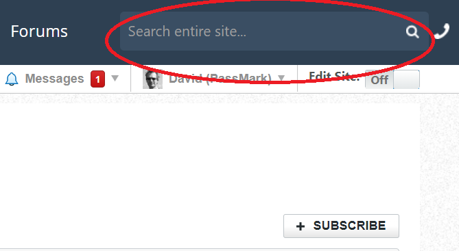

    There is a search box at the top right of each page that searches the forums and the rest of the site.

      I thought that search box was just for Passmark website itself and not the forums. Usually you can search just a particular sub forum to avoid a lot of useless results.
