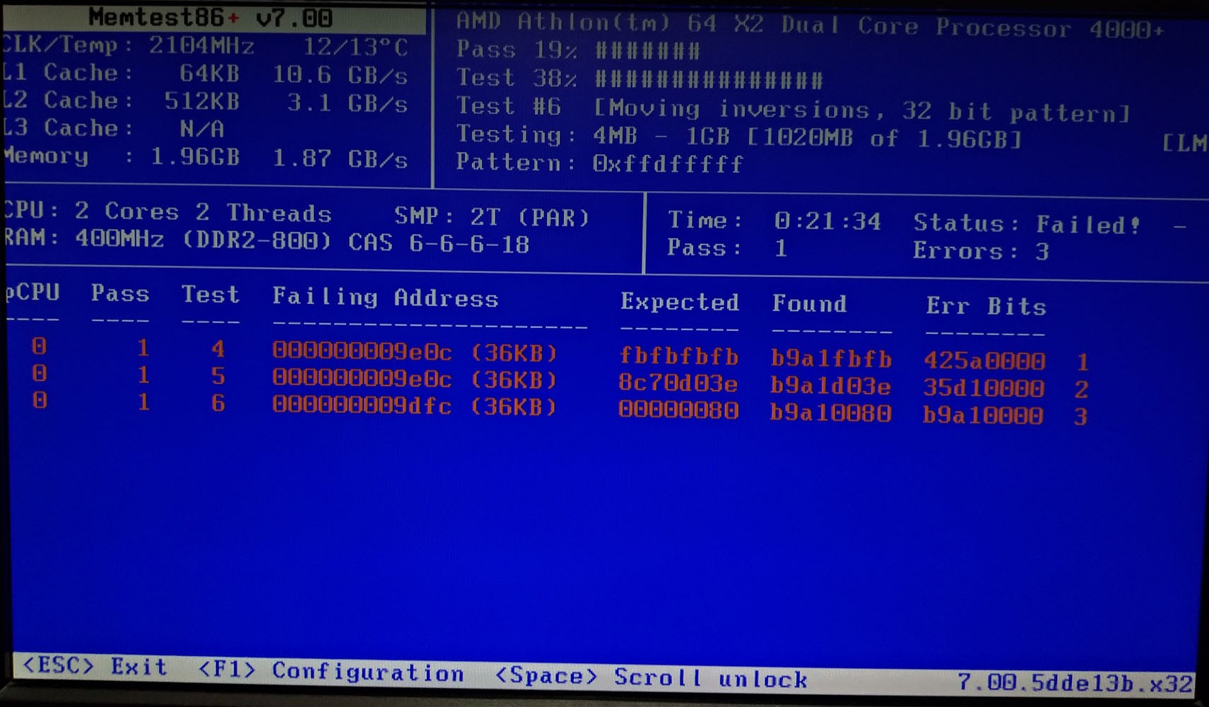

    So I ran Memtest86+ (I know it is other software) and had an error, so I went back to my old 1G 667MHZ module and it presented the same address error.
    It seems that its the 32 bit version (lower right corner)
    This Motherboard has ATI x1200 integrated graphics wich uses shared ram, and I reduced to 32MB to maximize the testing area, Memtest86+ seems to have excluded the blocked RAM area. So I suspected of a false positive, because a known good module presented errors.

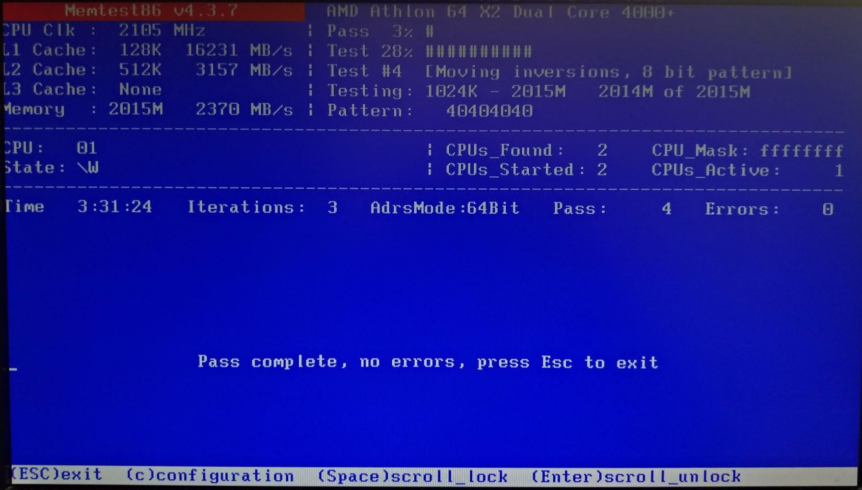

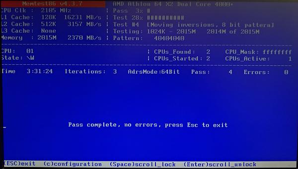

    Then I Installed Passmark Memtest86 v4.3.7 because my mobo does not support UEFI.
    And I passed 4 times the KVR800D2N6/2G module with no issues. but it seems to be testing the 32MB area because it shows Testing: 1024k-2015M.
    I´m assuming the Memtest86+ gave false positive because 1G 667 and 2G 800 modules presented the same address error And Passmark none!

    Yes, I would also assume that if you are getting the same errors at the same address range with two different RAM modules, it is a wrong results from MemTest86+.
    Those error addresses are very low in the memory address range, and it is usually the case that nearly all the low addresses are used by other memory mapped hardware and BIOS (and thus shouldn't be tested).
    But MemTest86+ (with the "+") isn't our software, and we can't really help you with it.

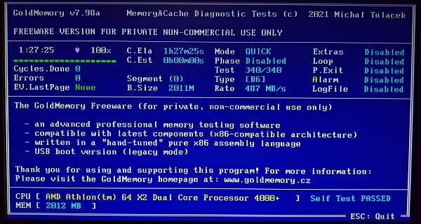

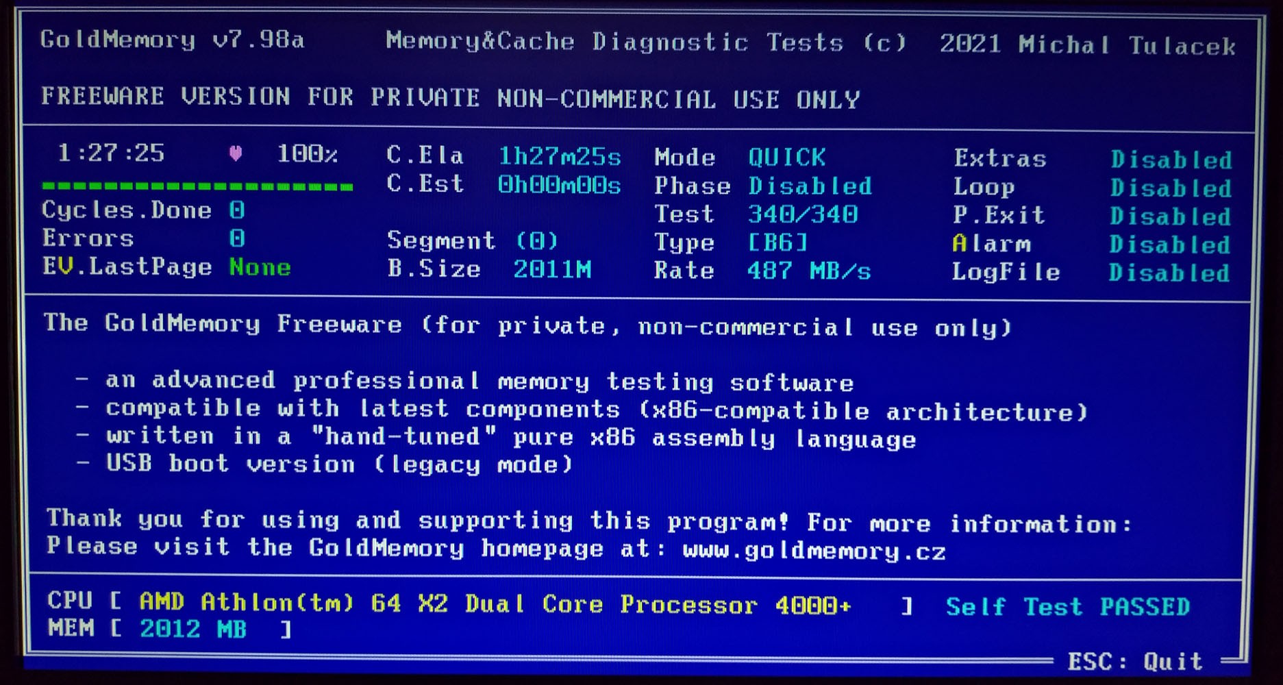

      Right,
      Just for the record, also passed Goldmemory with no issues.
      Thank you very much! it is an honor talking to you!
      Greetings from Brazil!
