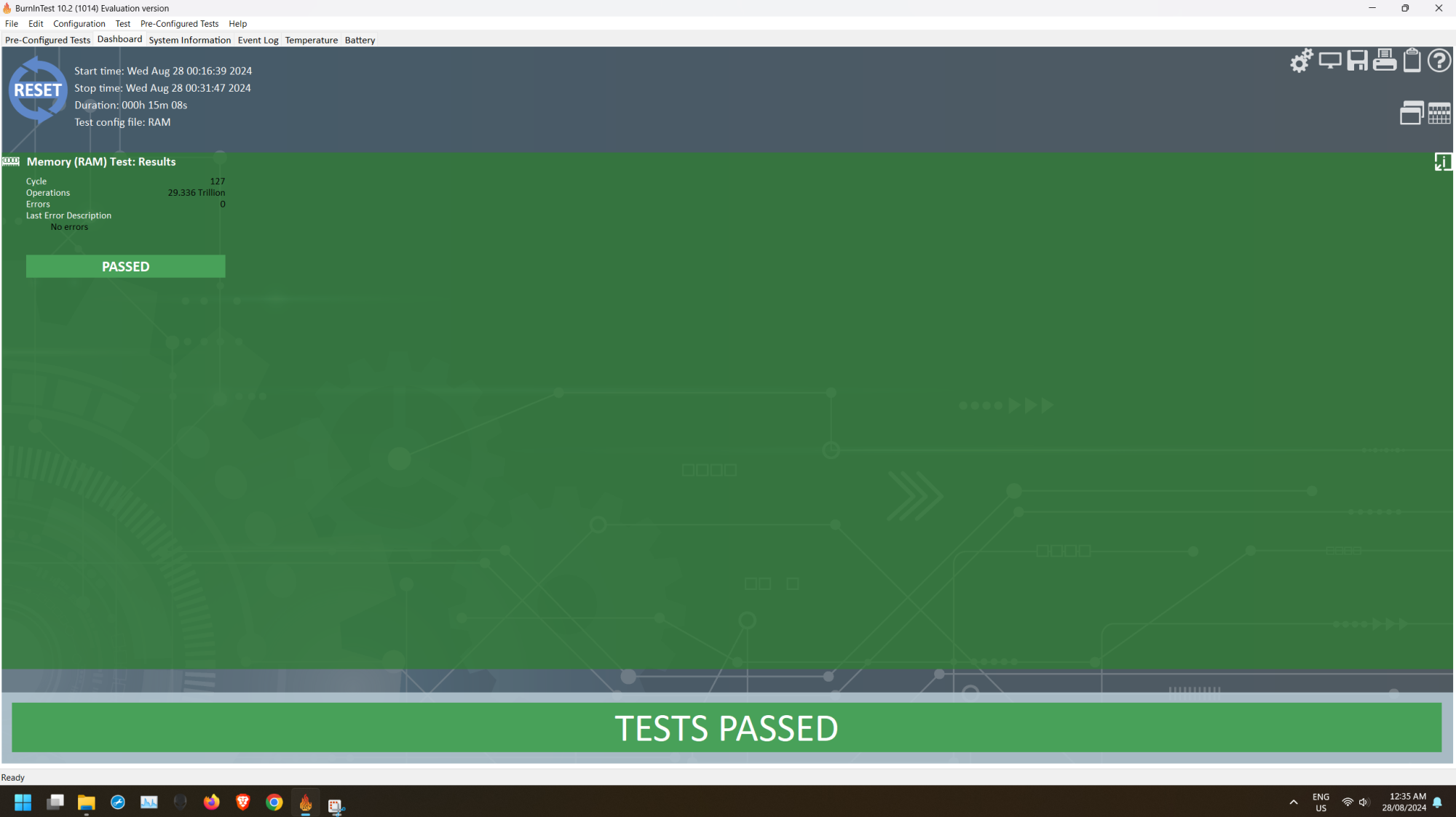

    I ran another RAM memory test using BurnInTest trial software and there were no issues/runtime errors identified with the 128GB ran - further adding to my confusion. I have also used the RAMMon free software from Passmark Software to assist with troubleshooting but I cannot seem to identify any problems that would cause the MemTest86 FAIL result, after the upgrade to 128GB.
    Could you please assist by reviewing the attached MemTest86 results and logs, after the RAM upgrade. I have also attached screenshots of the results from the BurnInTest software.

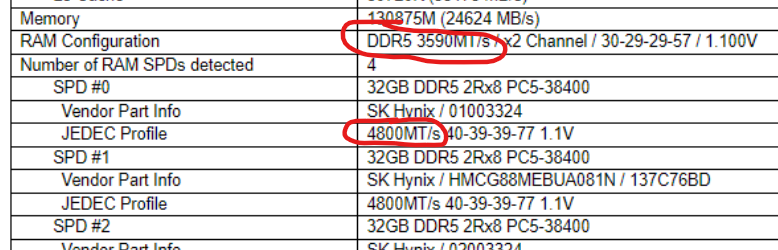

    Looks like bad RAM.
    But also the BIOS setting might not be optimal.
    You seems to be running at 3590MT/s with tight timings.
    But "best" speed might be 4800MT/s with longer timings.
    (this might not fix the problem however)
