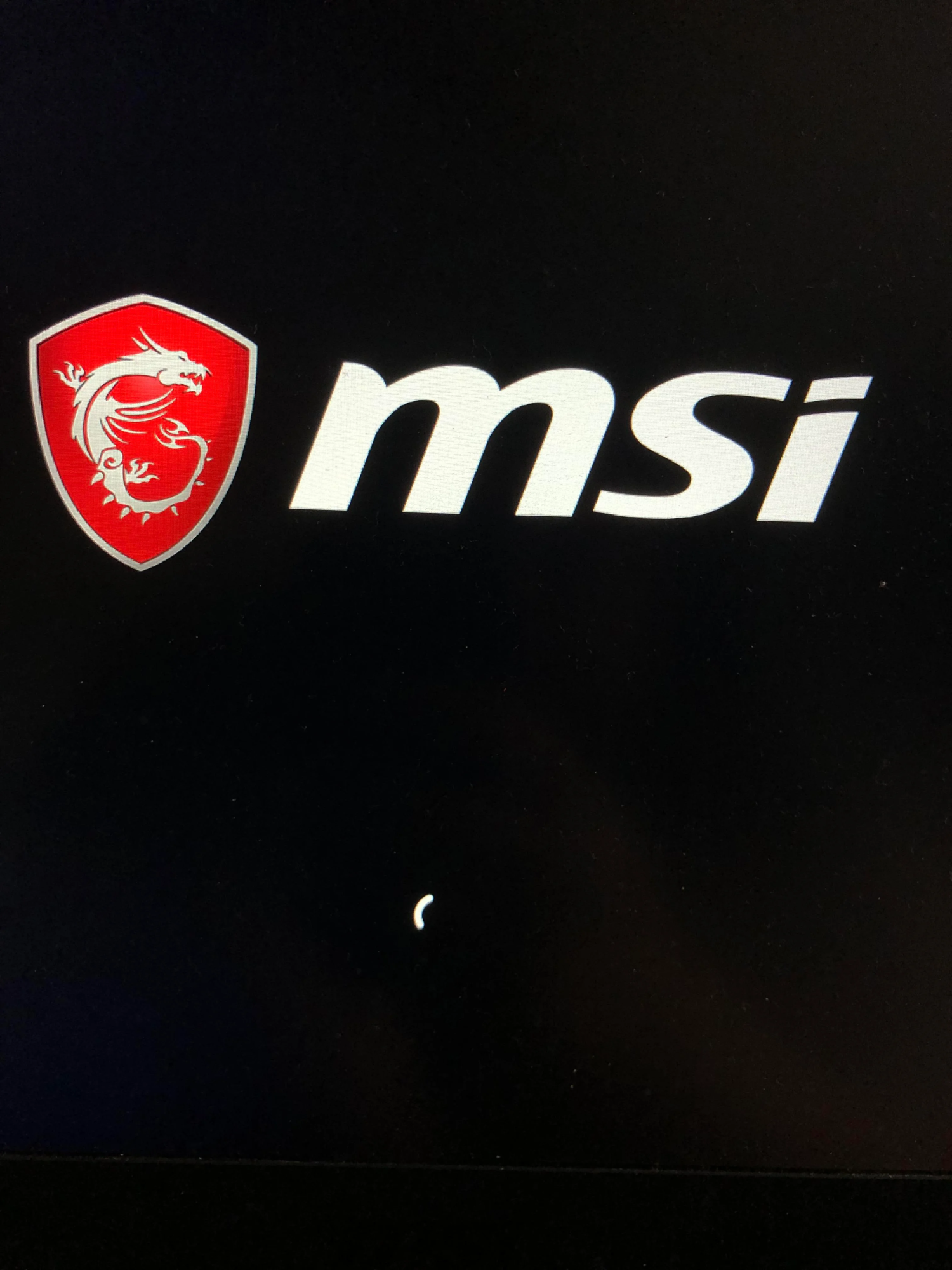

    Hello Experts,
ID:	57791​Click image for larger version
    I have a msi laptop which gets stuck in the logo no matter what I do. I can get to bios menu and see all hw details and move through all menu. If I try to reinstall windows from a bootable usb drive it also gets stuck on the logo when trying to boot from the usb.
    I ran memtest86 and as you can see the picture it gets stuck at cpu msr data. I then checked the memtest logs and found that all three times it stops at here exactly before I forcefully turn it off.
    GetIntelArchitectureSpecificMSRInfo - MaxRatio = 94
    GetIntelArchitectureSpecificMSRInfo - Mult = 2068
    GetIntelArchitectureSpecificMSRInfo - raw_freq_cpu = 2211366
    EnableTurboMode - MSR[1A0] = 0000004000850089
    EnableTurboMode - New MSR[1A0] = 0000000000850089
    EnableTurboMode - MSR[0x198] = 00001CD000001500 (Current multiplier: 21)
    EnableTurboMode - MSR[0x199] = 0000000000001500 (Target multiplier: 21, Max1CTurbo: 41)
    EnableTurboMode - Setting MSR[0x199] to 0000000000002900
    I repasted the CPU and ran again. It's getting stuck at the same location. Has the cpu gone bad?

      Ran it for 30 mins and still stuck at the same place. Logs attached.

          No RAM was changed. Few weeks back I found out when plugging the power adapter that the battery is not charging. When try to powering it on it gets stuck as above. Then I found out that battery is inflated and it has no voltage on it. The cmos battery is also dead. So I swapped both and new battery started charging normally. But the device is still stuck as above. I changed to a new RAM along with a new SSD to reinstall windows. And as I mentioned above the new installation is also stuck.
          So I did a memtest86 as it's only test known to me which has its own bootable drive that runs independantly while MSI is lacking any such HW/device test that can be done like that and it's stuck there too. I am trying to understand what's the significance of it stopping at that specific log.
