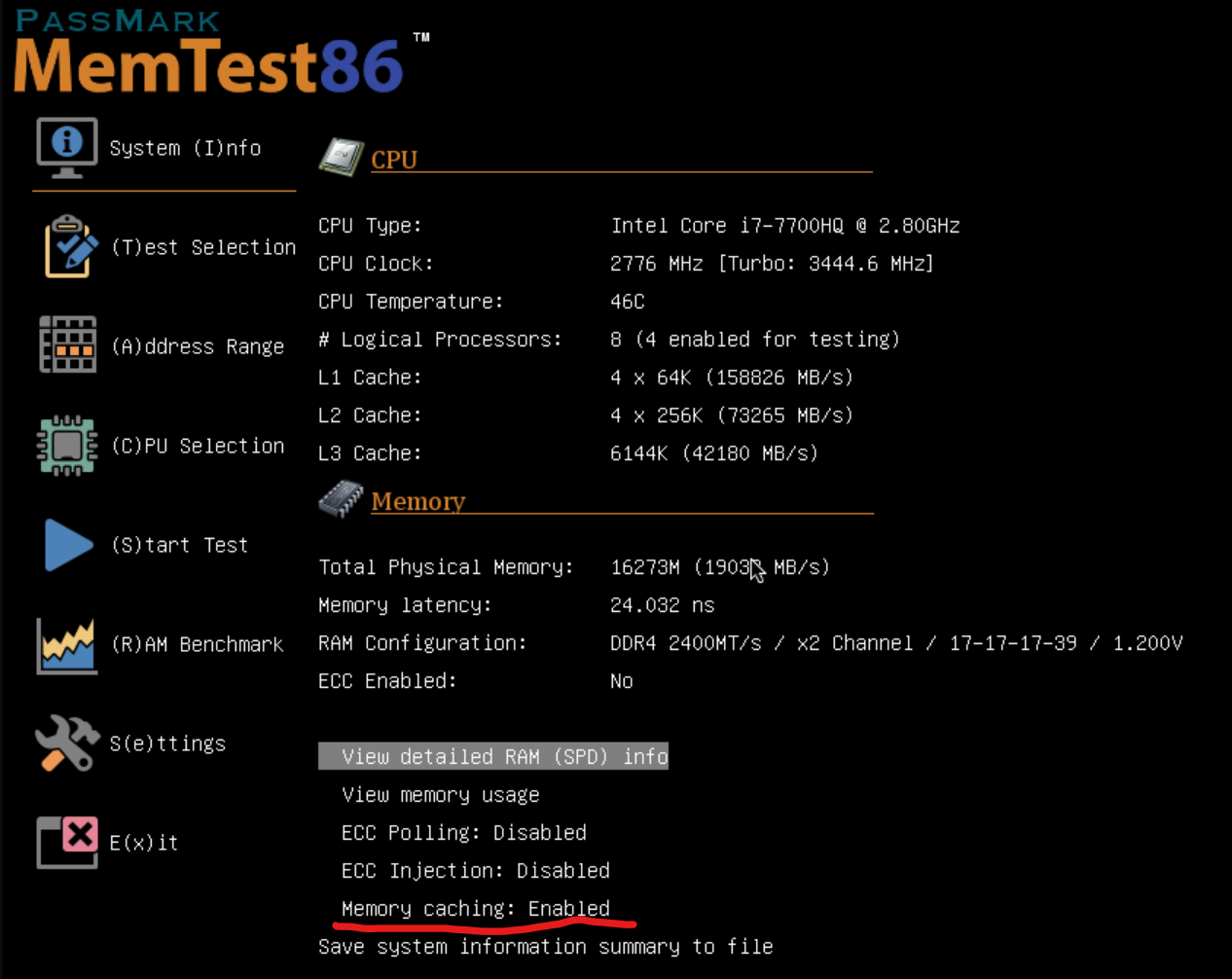

      I bought Memtest86 PRO version and went through the menu and didn't see anything that looked like it had to do with the caches, what menu is it under and what's it called? ( I could have just missed it)...
        • 337
        Its in system info page:
        Click image for larger version  Name:	image.png Views:	0 Size:	126.8 KB ID:	58968
        Navigate down to 'Memory caching..' with arrow keys, press Enter and it will show some options to select​ and press Enter to confirm

          That would be why. I just thought that was info telling me the cache was enabled. I didn't think you could change its status from that page... I will check it later tonight. I can't reboot atm cause I am in the middle of stuff.

                You really should put something like a yellow line or something under that text to let people know it is not just displaying information, but is actually clickable and you can change the settings there. I went right past it because I thought it was just telling me the cache was enabled, not that I could click on it and change the settings...
